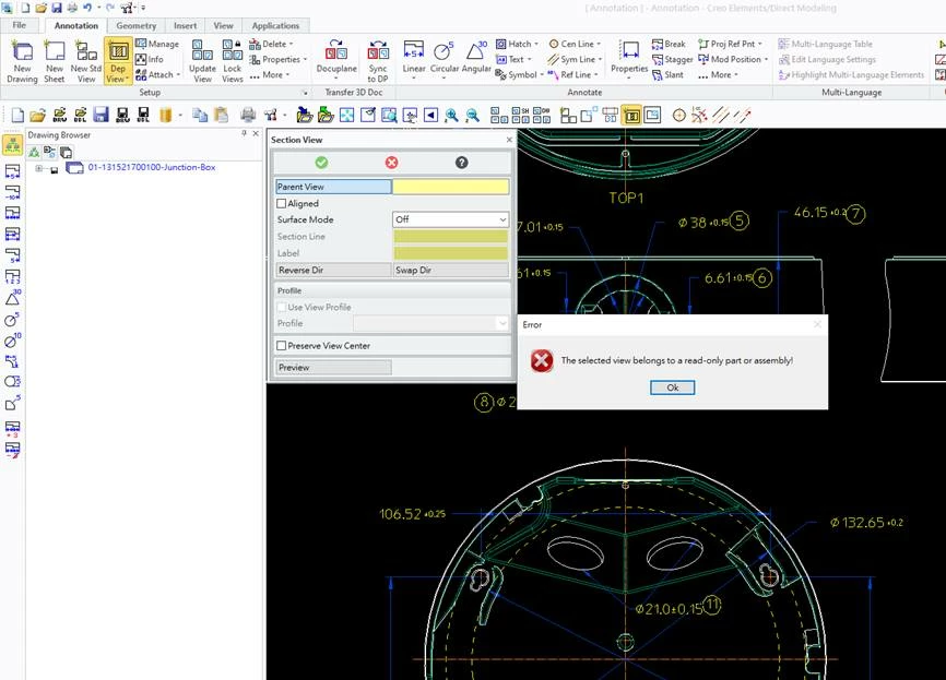

I am currently encountering an issue while using CED 20.6. Specifically, when attempting to insert a section view while editing a drawing, I receive the following error message: "The selected view belongs to a read-only part or assembly," which prevents me from proceeding with further edits or operations on this view.
I have attached a screenshot of the issue (please refer to the attachment) for your reference.
I have attempted the following troubleshooting steps, but the problem persists:
  1. Verified whether the part is set to read-only mode.
  2. Restarted the software and reloaded the drawing.
  3. Tried loading different parts, but the issue remains the same.
Could you please advise on how to resolve this issue? Is there a way to adjust the settings to remove the read-only status of the view?

Oct 31, 2024 9:46 AM UTC
You may read documentation at https://support.ptc.com/help/creo_elements_direct/r20.7.0.0/advanced_documentation/goodies/Readme-0022.html and/or https://support.ptc.com/help/creo_elements_direct/r20.7.0.0/advanced_documentation/goodies/Readme-0098.html
enter the command
(load "dbdialog")
and the tools box button will offer you a dialog to manage objects flags as clearing Read Only.
Assume your choices.
