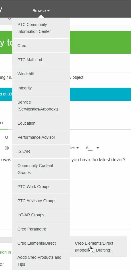

The issue was the graphics card driver.  Do you have the latest driver?
Also in the future, place your posts here to make them easier to find.
