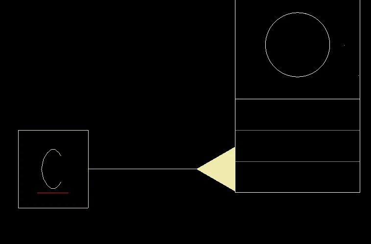

Looks like the solution is to add a 'Draft Datum' on entity. The pick / click sequence is cumbersome & strange:
Annotate, Draft Datum, select 'point on drawing or entity', click the edge in the applicable view, click OK, click the same edge again, click OK again, then 'Enter DATUM NAME' window pops up, enter letter, click the check mark to accept, cancel to exit the draft datum window, right click on the new datum letter, go to properties, select display as a GD& datum, click OK, click drag handles to position as desired.
But it works - at least, no complaints from Creo about 'duplicate labels'. The properties for the drawing for 'gtol_datums' need to be set to 'std_asme'.

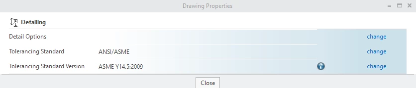

September 7, 2021
We are currently working to the 2009 version, and Creo is set to that:
Is there some other setting involved, as well?
