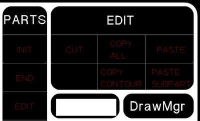

For other situations, I do not see the problem of using the tablet menu PASTE: you do not have to use the mouse.
