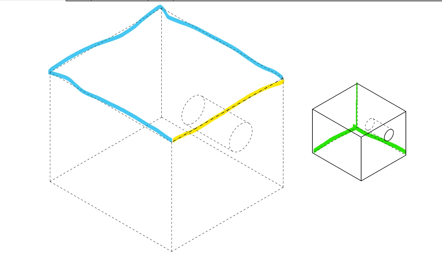

When I export a PDF, the phantom and hidden lines appear to be the same, but in the Creo drawing, it’s clearly different. The only way I found that will reflect the phantom line geometry is what I did with the line highlighted in yellow. I described how I did it below.
Does anyone know how to fix this? I want to use the component display to make the lines phantomopque, and have it reflected when I export a PDF.
Yellow - I went to display<Line Style<Modify Lines<PHANTOMFONT
Blue - I went to Component Display<PhantomOpque
Green - Hidden Line
Thank you to anyone who can help.

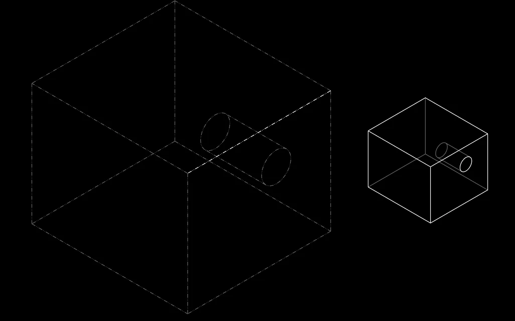

Here is the pen table I am using
pen 1 thickness 0.03 cm; geometry
pen 2 thickness 0.005 cm; dimensions
pen 3 thickness 0.02 cm; hidden; pattern .1 .1 cm;
pen 4 thickness 0.005 cm
pen 5 thickness 0.03 cm; sheetmetal green
pen 6 thickness 0.015 cm; curve_color
pen 7 thickness 0.001 cm
pen 8 thickness 0.015 cm; green textpdf
