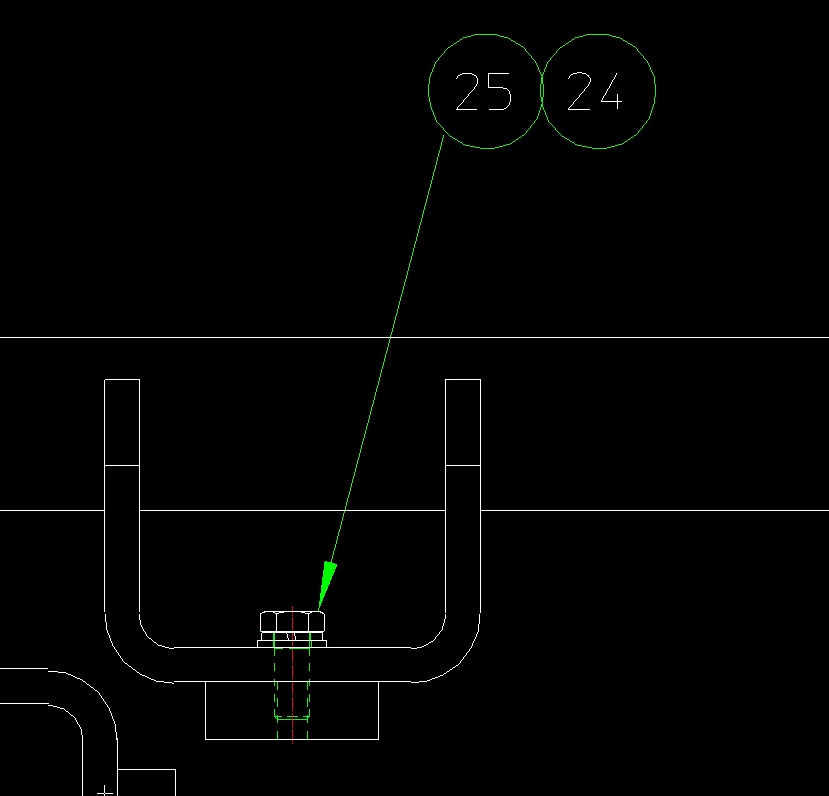

I wonder if it's possible to merge 2 balloons to 1, so there are not 2, 3, 4.... Ref lines to 1 point (Bolt - washer - ....)
I have wondered the same thing, but haven't found anything so I do as you do on the attached file.
Hi Danny,
One BOM flag for 1 item. The BOM flag contains the reference to the model (sysid if you are using Standalone BOM), or the Model Manager document (ELID if you are using Model Manager).
Wim.

Hi Wim,
Is there a way to align different balloons?
Hi Danny,
Only way I see is to draw a horizontal construction line to align them.
