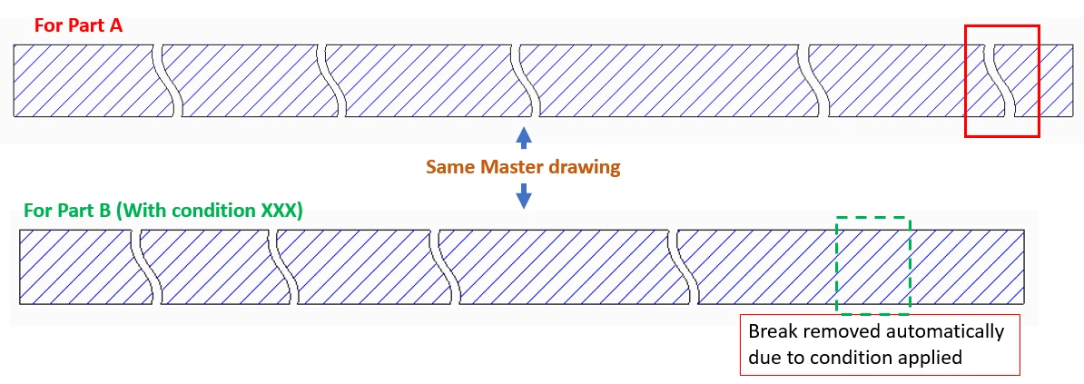

I have created a master drawing and master model, from which i generate individual drawings for few parts.The parts are long, so that, I've added Broken view in the drawing with multiple breaks.
Now, there are few drawings, where I need to remove couple of the break points form the broken view due to some reason.
This can be manually done by removing from view properties. But i would like to know if there is some automatic way to remove the required break point  upon generating the drawing.
Can this be done by providing a condition in drawing program or use mapkey etc?
For example:
In the attachment, drawing generated for Part A from the master drawing has multiple breaks. But when drawing is generated for Part B from the same master drawing, the highlighted break is not required.
Any help would be really appreciated.
