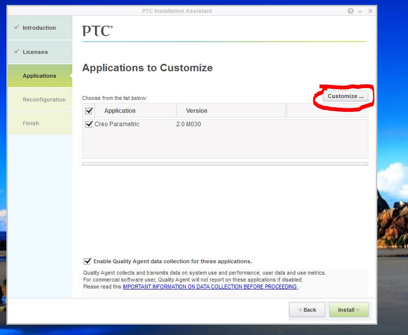

You don't have the manufacturing module loaded. That is why you don't have any sequences.
Creo has a new .EXE file that replaces the the old ptcstup.bat, you need to run it and reconfigure your setup, it is reconfigure.exe.
it is in the folder C:\PTC\Creo 2.0\Parametric\bin
you need to get to this screen, then press the customise... button

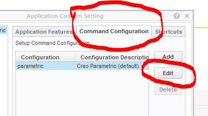

then select the tab highlighted then select EDIT

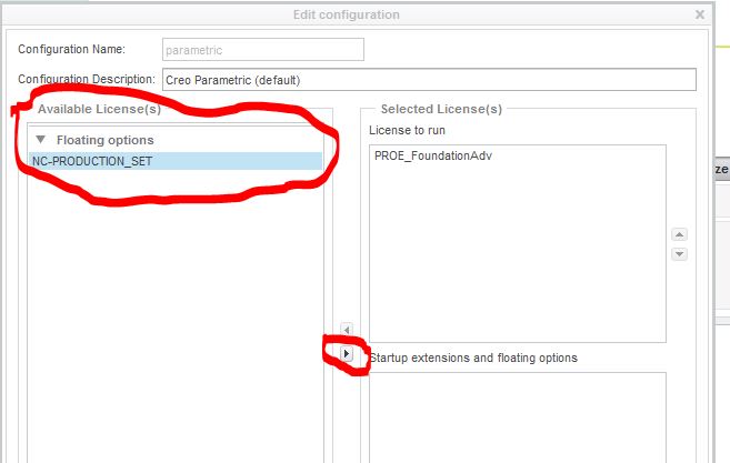

you can then select the arrow for the floating module, this will expand to show what modules your license supports, then use the arrow highlighted to install.
this should get you out of trouble.
