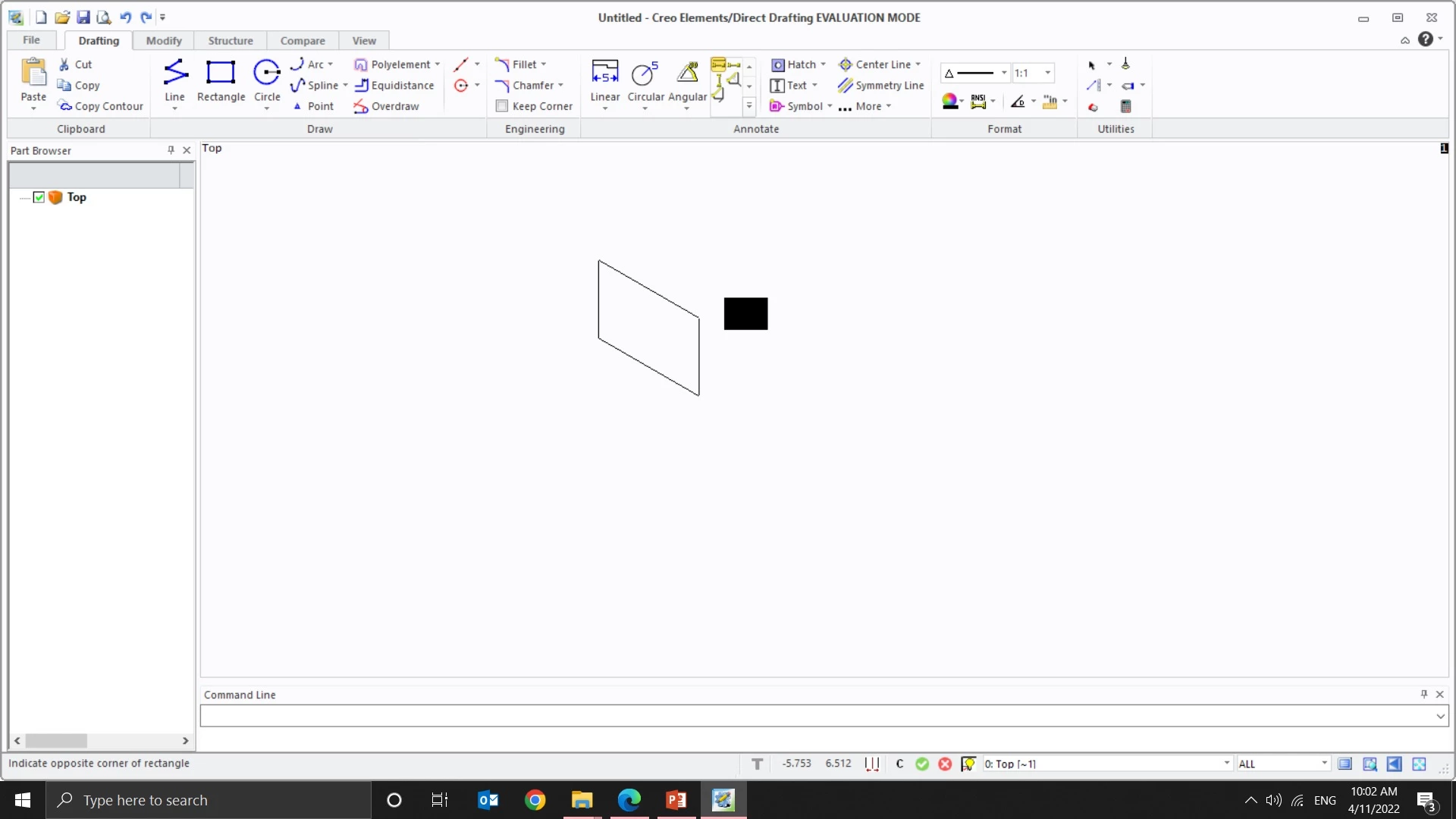

I have some question about using Element drafting 20.1.4 as below ;
1. I create geometry whatever line rectangle circle, it show black box instead show value . What cause of this problem ?
2. When I create rectangle, it not parallel with monitor as capture screen.
(Please see capture screen in attached file for clearly understand )
If I guess, all of this problem cause from Evaluation mode ?   I'm not sure.
Anyone who have experience about this problem. Kindly guide me how to solve this problem

1. This should be the values x and y of the current position of the cursor. You can change foreground and background to see the text with:
Tab File > Settings > System...> Copilot
and then "Text Box" "Text" and "Bakground".
2. You are in the isometric mode. You can change back to normal with:
Tab View > Drafting > Setup >
and then Grid... > Reset

Nothing to do with evaluation mode.

Dear  @Kotom-Eng
Thank you for your helpful
I'm already set as your recommend, it's work !
