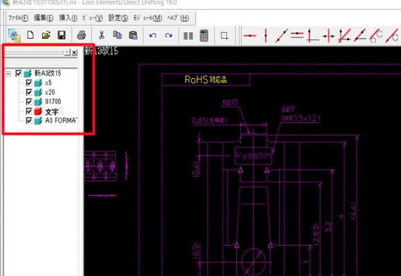

I use Creo Elements/Direct Drafting (Mixed UI).
I want to turn on Part brower as the below picture to manage layout. Please guide me how to turn it.
I appreciate your prompt response.
Aug 5, 2024 4:01 AM UTC
If you type
wui_part_browser
in the user input line and press return it should open the Part Browser for you..
I hope this helps!

Aug 5, 2024 5:07 AM UTC
It is exactly what i needed. thanks for your help.
