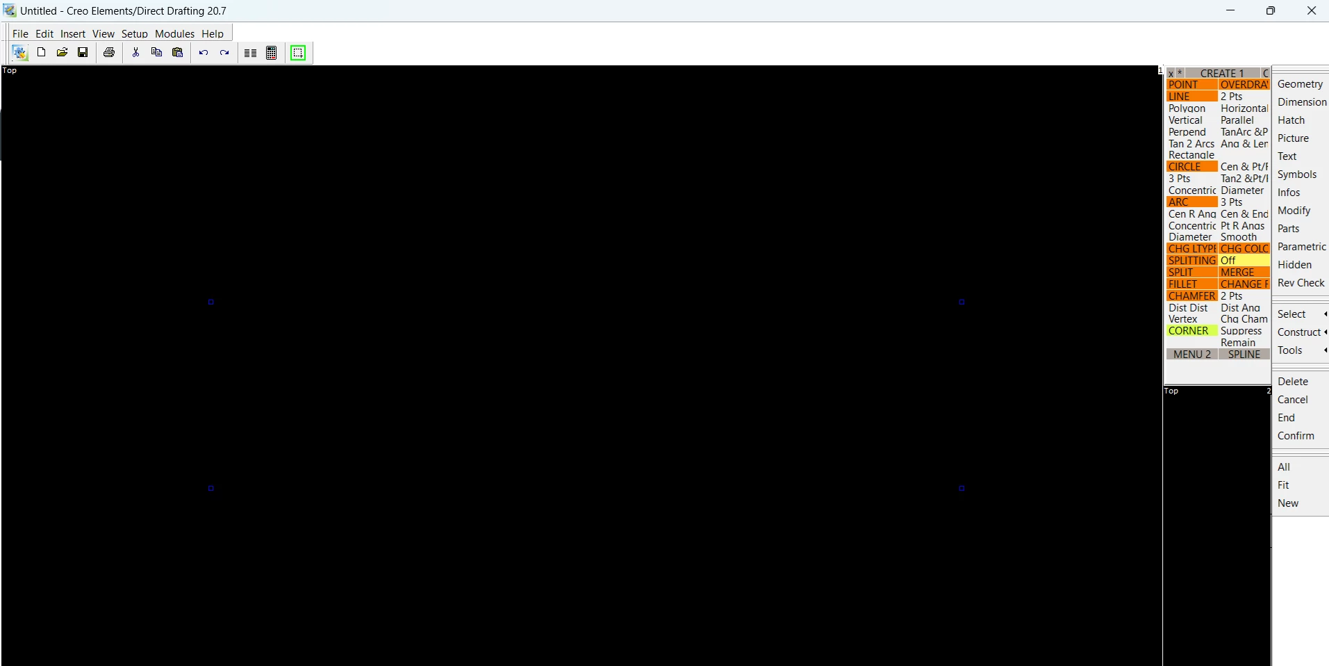

Why it not show Drawing Creo elements/directs drafting Mixed UI
I use Creo elements/directs drafting Mixed UI 20.7 on Lenovo LOQ gaming 2024 having RTX 2025 Nvidia
When I draw any Geometry (Line, Circle, Point, Rectangle,...), I can not see it on display
I had tried to solve by checking Geometry setting, Viewport -> setting, Setup -> show -> Layer. But all fault.

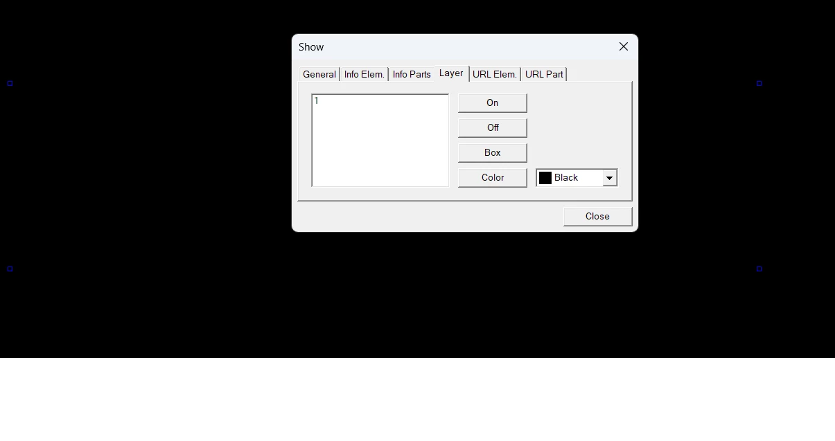

I see that I open Setup -> show -> Layer, change color to White and save. But, when I open again. It is still default with Black. whether is that the cause? What is the way to get ?
Or. Who are know the tips to fix it? Thanks

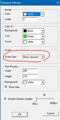

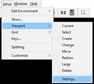

May 16, 2025 4:55 PM UTC
That could be also a change in viewport configuration
Try other settings
