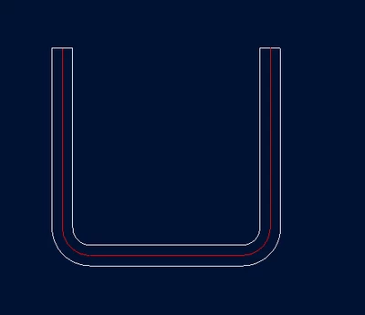

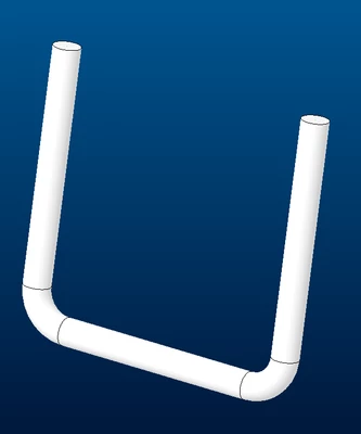

Hello, I have a part which looks like this.
I need to create a drawing of this.
On the drawing i have to have length of the wire.

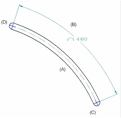

How can i create a length dimension of it's centerline that look's like dimension on following image.

On Modeling, with the standard tools, you cannot add a dimension on a symmetry line. As a workaround, create an arc on the symmetry line and put a dimension on it. Attention, if you modify the 3D, the arc will not be updated.
On Drafting, you can add a dimension on a symmetry line.
