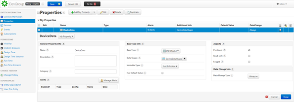

    1. Added a property in the thing template with the name DeviceData and selected the basetype as info table. Also selected the previously created data shape (Device Data) in data shape field.
    2. And made this property as persistent data by selecting Is Persistent.
    3. Saved the property.

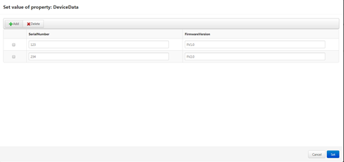

  3. Created two devices with the names Device1 and Device2. Both the devices use the above template. Now for each device set the property values by clicking the set button in properties link. These values will be persistent, meaning they do not change even after refresh or when you restart ThingWorx. You can even set these properties at run time by just creating a service.

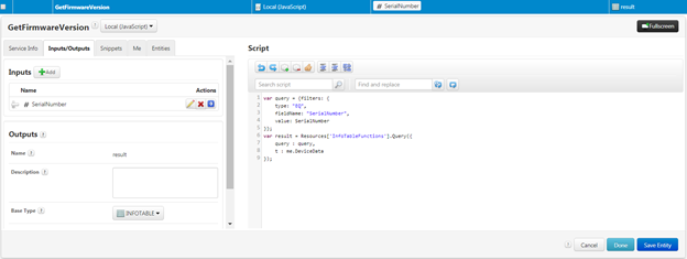

  4. Created GetFirmversion service which retrieves the firm version of given service number.

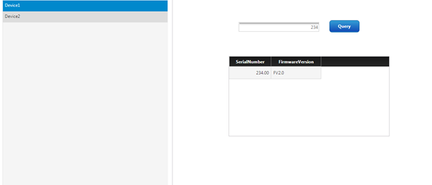

  5. Created mashup as shown below:
Once you select Device1, enter the serial number in the numeric entry field and click query button, the firmware version of the given serial number is displayed along with the data of device1. If we enter a wrong number, no data will be displayed. You can also set an error message instead of displaying empty values.
Similar case when we select the device2 data.
