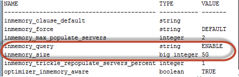

We should now be able to confirm that, via SQL*Plus, certain amount of memory, 5G in my case, has been assigned to the In-Memory Column Store feature
SQL> show parameter inmemory

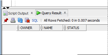

Just to confirm that the data is still not populated since we have only marked the table to be eligible for In-Memory Column Store, if I now query the dynamic view V$IM_SEGMENTS for current usage of the InMemory, it'll confirm this:

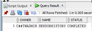

So now let's populate the In-Memory with a query which would require full table scan, e.g.
SQL> select property_name, count(*) from sensorhistory
          Group by property_name;
Let's recheck the dynamic view V$IM_SEGMENTS

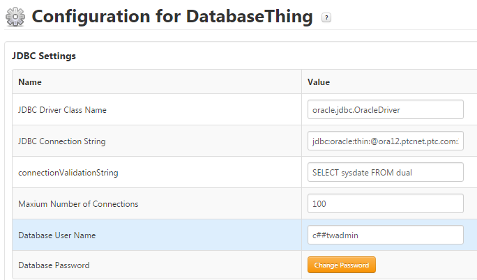

Step 2: Create a Thing using the OracleDBServer12 Template, part of the extension we just imported
Step 3: Here's how a valid configuration would look like to successfully connect to the database, ORCL in this case
