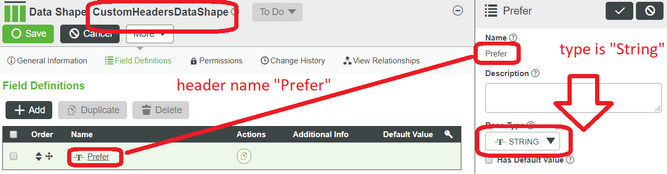

Step 1. Create a Datashape say "CustomHeadersDataShape" and add a string field with Name the same as the header name you want to add. In this case, I want to add a header called "Prefer" so it will look something like

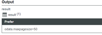

Step 4: Save the service and execute "GetCustomHeaderParameters". You should see something like
Now your custom header "Prefer: odata.maxpagesize=50" is set. further execution of your connector services will consider this header until it is reset.
