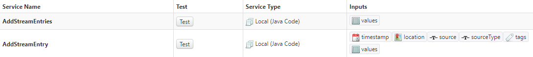

The AddStreamEntries​ snippet does not offer too much information, except that it needs an InfoTable as input.
It is however based on the InfoTable for the AddStreamEntity service.
To use the AddStreamEntries table, an InfoTable based on sourceType, values, location, source, timestamp​ and ​tags​ must be used.

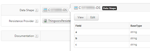

In this example, I started with a new Thing based on a ​Stream​ template and the following DataShape:
This DataShape must be converted into an InfoTable with is used as the ​values​ parameter.

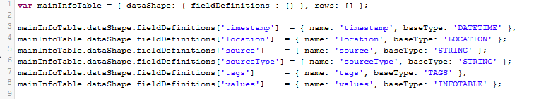

// *** SET UP META DATA FOR INFO TABLE ***
// create a new InfoTable based on AddStreamEntries parameters (timestamp, location, source, sourceType, tags, values)
var myInfoTable = { dataShape: { fieldDefinitions : {} }, rows: [] };
myInfoTable.dataShape.fieldDefinitions['timestamp']  = { name: 'timestamp', baseType: 'DATETIME' };
myInfoTable.dataShape.fieldDefinitions['location']  = { name: 'location', baseType: 'LOCATION' };
myInfoTable.dataShape.fieldDefinitions['source']    = { name: 'source', baseType: 'STRING' };
myInfoTable.dataShape.fieldDefinitions['sourceType'] = { name: 'sourceType', baseType: 'STRING' };
myInfoTable.dataShape.fieldDefinitions['tags']      = { name: 'tags', baseType: 'TAGS' };
myInfoTable.dataShape.fieldDefinitions['values']    = { name: 'values', baseType: 'INFOTABLE' };

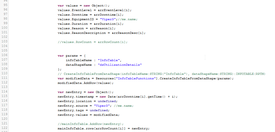

EDIT: I was able to solve the problem by creating a DataShape Thing containing [location, source, sourceType, tags, timestamp, values]. Instead of defining the InfoTable object at the top, I used the CreateInfoTableFromDataShape(params), like it does in the middle of the code.

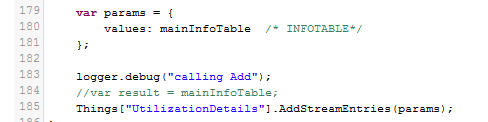

Hi Michael;
This code example has been quite helpful in explaining how to use the AddStreamEntries() service. I have seen very few examples of it, and I've had to go away from the AddStreamEntry() service due to unreliability to process the quick, looping calls that are being done while parsing a file. I have implemented your logic in a few different places, however, following the same logic in each service implemented, one of them has an error that I cannot resolve:
- Wrapped java.lang.Exception: Unable To Convert From org.json.JSONObject to INFOTABLE
The blocks of logic that are implemented in each of my services includes the following:
Creating the high-level InfoTable that will be used in the AddStreamEntries() call
Create a JSON Object that stores the stream-data we will be storing, Create an InfoTable, add the Object to the table, Create a JSON Object for the stream metadata, and add the Object to high-level InfoTable from above
And finally, call AddStreamEntries() with the high-level InfoTable that has been expanding throughout the looping process
These core features are present in three other Services, and those all work great. However, the last Service gives the JSON-to-InfoTable conversion error. I have tinkered with using some different calls, including FromJSON(), but have not had any luck.
The dsUtilizationDetails datashape does not have any Primary Key on it, and matches the "values" Object() being created in the code.
Any help you can provide would be appreciated.
