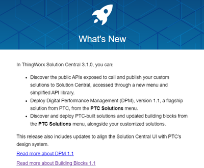

Solution Central 3.1.0
ThingWorx Solution Central (SC) is the solution management tool for ThingWorx and Digital Performance Management (DPM), the latest version of which (DPM 1.1) can now be deployed directly from the PTC Solutions menu of SC. Streamlining packaging strategies and ensuring efficient solution deployment can now be done for all kinds of ThingWorx solutions, even those with heavy customization. The new API allows for updated building blocks from within the PTC Solutions menu to be easily discovered and deployed right alongside custom solutions. Even the most advanced developers can now house their deployment management process within SC.

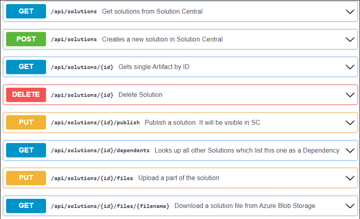

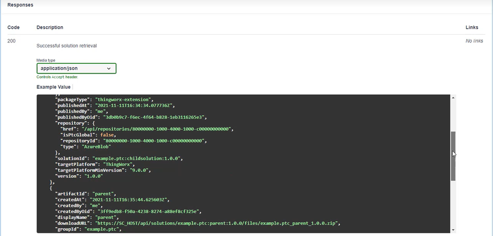

Within Solution Central, a new menu option has been added to review the API, with information about the different types of requests and their parameters and responses. To access this within the Solution Central UI, open the help menu and navigate to “Public APIs” (see the image on the right). To see a sample response, select a request type and scroll down to the “Responses” section (shown below). Examples of error responses are also provided, and it’s important to ensure that whatever makes these requests can properly report or log any errors for troubleshooting and maintenance of the DevOps process.

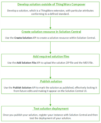

imageThe general steps for making use of this API are as follows:
  1. Create the solution resource with a POST
  2. Add some files to that solution with PUTs
    1. First, create the solution archive with the right Solution Identifiers; this should contain at least one project XML and all of the entities belonging to that ThingWorx project
    2. Next, compute MD5 using a tool like DigestUtils on the contents of the archive; this checksum is required for Solution Central
    3. Compute the SHA hash on the archive and save it; this will need to be provided along with the archive in the PUT requests
    4. Compute MD5 on the hash file also
    5. Finally, make the two PUT requests, one for the archive and one for its hash; for example cURL requests, see the Help Center
  3. Publish the solution using a PUT
