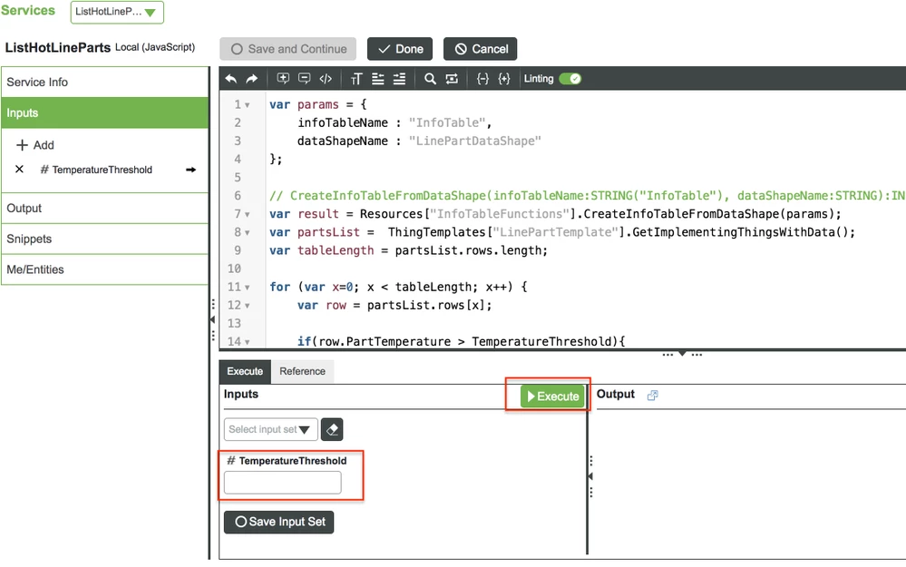

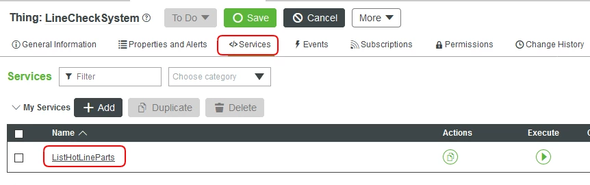

  1. Open the LineCheckSystem Thing.
  2. Select the Services tab.
  3. Click the ListHotLineParts link.
If you scroll to the bottom of the page, you will see the Execute window. Enter a value for the TemperatureThreshold and click Execute.

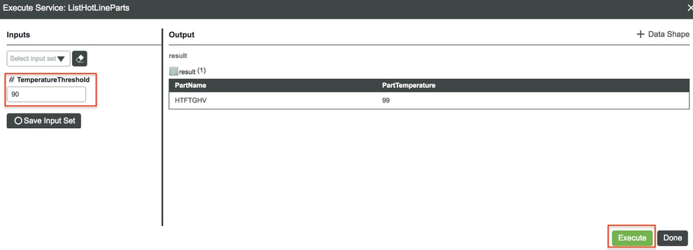

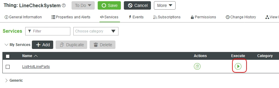

  3. Click the ListHotLineParts Execute play button.
  4. Enter a value for the TemperatureThreshold and click Execute.

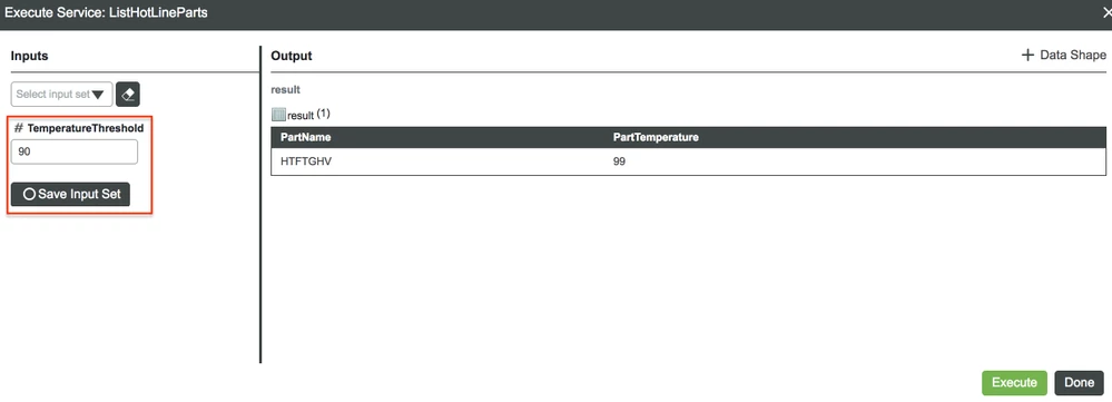

Saving Test Cases
Store input parameters makes testing during development and after development much faster. Whether you are testing base cases, specific scenarios, or throwing everything you possibly can at your Service, this tab will allow you to store and name test cases for later usage.
During Development

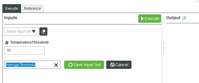

    If you scroll to the bottom of the page, you will see the Execute window. Enter a value for the TemperatureThreshold and click Save Input Set.
  4. When prompted, enter a name for this test case and click Save Input Set.
After Development
  4. Enter a value for the TemperatureThreshold and click Save Input Set.
  5. When prompted, enter a name for this test case and click Save Input Set.
While this example is pretty simple and straightforward, it is also possible to store other values and other data types! You will be provided with a dropdown of your stored test cases. Just select a case and click Execute.

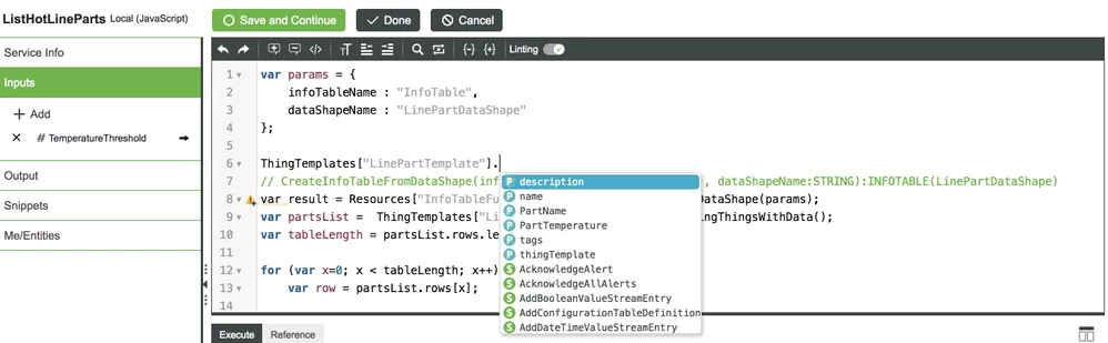

Step 4: Utilize Code Auto-Complete Feature
  1. If it is not open already, open the ListHotLineParts Service or create a new one.
  2. On a new line, enter ThingTemplates["LinePartTemplate"].
  3. Add a period . after the closing bracket to gain access to the Services and Properties of the Thing Template we created earlier.
You will now see the Services and Properties that were created inside of the LinePartTemplate or passed down in its object-oriented model.

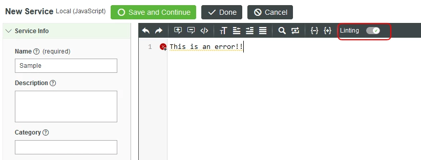

Step 5: Test Code at Design Time with Linting
Linting is a process by which your development environment warns you of possible issues even before any attempt to run or test the code. Instead, an in-editor warning pops up that alerts you to the issue as you’re writing your code. Linting is yet another feature which many IDEs provide outside of the IoT realm.
  1. Select the Lint checkbox at the top of the Service-editing section.
  2. Type any statement that would cause a Lint warning or error to pop up. In this case, it is best programming practice to use a semi-colons at the end of JavaScript code.
