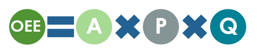

At the highest level of the reason tree, the trunk, there are really 3 categories: Availability (A), Performance or Productivity (P), and Quality (Q). These should look familiar; they are the three dimensions of OEE (Overall Equipment Effectiveness).
Fg 1. Calculation of OEEFg 1. Calculation of OEE

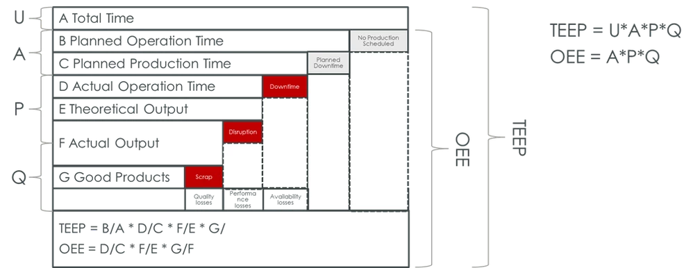

Productivity/Performance really refers to short stops, things that cause the machine to run at less-than- optimal speeds. This can include stops caused by running out of materials for production, doing minor maintenance like switching out a single, easily-changed part, or even frequent breaks due to ill health of an operator. User error can be a cause as well, say if the machine needs a certain heat to produce parts, and the heat keeps fluctuating (requiring the machine to take the time to calibrate for this before starting on production) because operators are smoking out a back door or adjusting thermostat temperatures.
Fg 2. Levels of Runnable TimeFg 2. Levels of Runnable Time
Operator influence often is a factor when it comes to the conditions that permit optimal performance from machinery, and every factory may face different challenges. Stops like these are not really outages; the amount of downtime isn’t enough to consider the production block entirely unproductive. Production was continuing and ongoing throughout most of the block despite the issues; the rate was just slower than ideal.
               Performance/Productivity = (Total Count / Run Time) / Ideal Run Rate

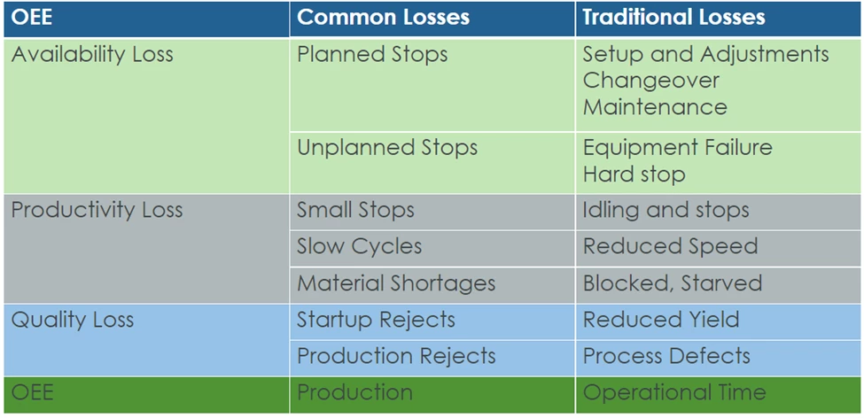

An example tree can be seen in figure 3 here, with leaves like “Changeover” and “Maintenance” being semi-ambiguous; they could just as easily be seen as unplanned stops. Therefore, there may be multiple reason codes mapping up to the top of the tree in more than one branch, and these can have different categories, which controls how the business logic responds to the different codes. The Help Center has more details about how the events are mapped to types, and each type contains multiple categories, as configured by you when you set-up the DPM model.
Fg 3: Different types of changeovers may have different codes, and can map up as either planned or unplanned, but all planned and unplanned stops (long stops) are under the Availability category of the trunk. Similarly, small stops can involve idling, like if there are not enough materials, reduced speed if the conditions are not ideal, or other small stops, usually caused by human error or unforeseeable circumstances. Quality loss then refers to the products which fail quality checks, either because the machine still has the wrong paint in the applicator and needs a few rounds to be ready for the next production item, or because the conditions are again, not ideal, and items wind up scrapped.Fg 3: Different types of changeovers may have different codes, and can map up as either planned or unplanned, but all planned and unplanned stops (long stops) are under the Availability category of the trunk. Similarly, small stops can involve idling, like if there are not enough materials, reduced speed if the conditions are not ideal, or other small stops, usually caused by human error or unforeseeable circumstances. Quality loss then refers to the products which fail quality checks, either because the machine still has the wrong paint in the applicator and needs a few rounds to be ready for the next production item, or because the conditions are again, not ideal, and items wind up scrapped.

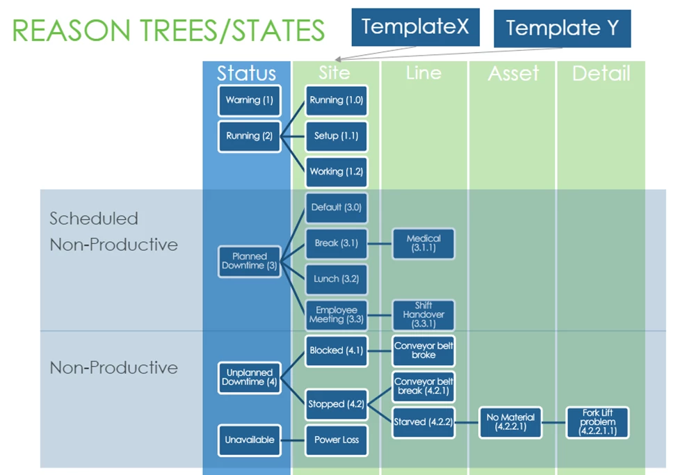

Example Reason Tree
Fg 5 example tree with more specific tags (there may be dozens or hundreds in a full reason tree, though the fewer are needed to capture the events we care about, the better).Fg 5 example tree with more specific tags (there may be dozens or hundreds in a full reason tree, though the fewer are needed to capture the events we care about, the better).
