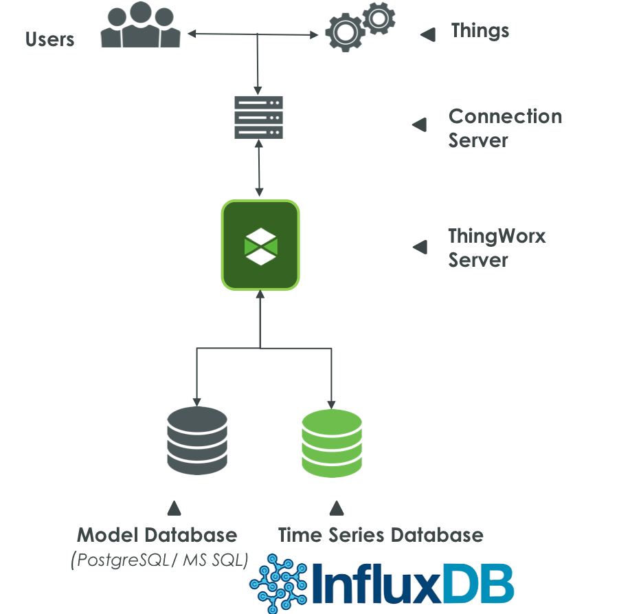

To start strategizing on how InfluxData can help you in your ThingWorx journey, here is a sneak preview of what it will look like:
New Features
The new ThingWorx Influx Persistence Provider will make query services like ValueStream Thing QueryPropertyHistory, Stream Thing QueryStreamData and QueryStreamEntries even better. Simply create a new instance of the persistence provider, configure it to use your InfluxDB instance, create a new value stream (or stream) from the new persistence provider, and you’ll be writing, reading and analyzing your time series data like never before.
