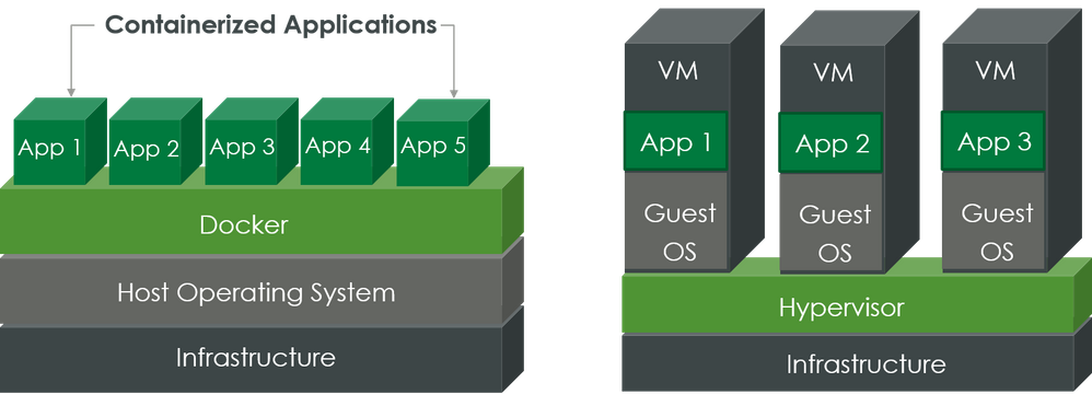

What's the difference between Docker containers and VMs?
Containers are an abstraction at the app layer that packages code and dependencies together, whereas Virtual Machines (VMs) are an abstraction of physical hardware turning one server into many servers. Here are some great discussions on it on Stack Overflow.imageContainers vs. VMs

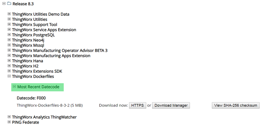

PTC provides the ability for customers and partners to build ThingWorx Docker images. A customer can download the Dockerfiles and scripts packaged as a zip folder from the PTC Software Downloads Portal under “ThingWorx Platform,” then “Release 8.3”  then“ThingWorx Dockerfiles.” (Please note that you must be logged in for the link to function properly.)
imagePTC Software Downloads PortalThe zip folder contains the Dockerfiles, template jar, and scripts to fetch Tomcat, and ThingWorx WAR files using CLI. Java must be downloaded manually from the vendor's website. We also provide an instructional guide called “Build ThingWorx Docker Images” available on the Reference Documents page on the Support Portal.

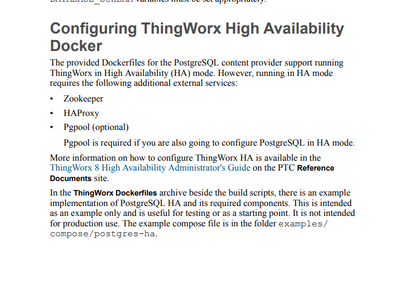

February 25, 2020
We are looking in High Availability architecture with Docker Container. The documents says that the docker images are provided for HA. Can you point me where to they are?
thanks,
Preeti
KayaEmeritusAuthor
Emeritus
February 26, 2020
Hi @PreetiGupta,
The docker support provided today is for Active-Passive  architecture for ThingWorx 8.X product releases. More information on building ThingWorx 8.3 docker images can be found here. We’re actively working towards ThingWorx 9.0 release where we will provide the High Availability architecture for  Active-Active Clustering setup. This feature will also have containerization support from PTC. It is currently under private preview and we’re happy to engage in  a conversation to provide necessary support in this direction if you are interested.
Best,
Kaya
February 26, 2020
Thanks. I have looked at the Docker PDF and HA PDF.
I do not see any thing mention about Dockers in HA guide. What level of Orchestration is needed for Active Passive Architecture.
The Docker PDF only has this tiny piece of information with no specifics.
thanks.
