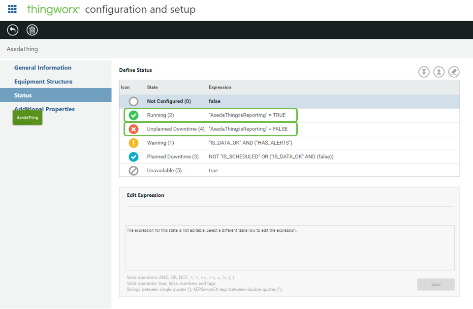

In ThingWorx 8.4 (coming in early 2019), the new IsReporting state will inform the user when a polling device is communicating on a regular basis. If it is, then IsReporting will be true. The IsReporting state resolves the discrepancy wherein devices that are on duty cycle appear disconnected due to the IsConnected state reporting false. imageNew "IsReporting" state improves visibility of an asset's communication state
