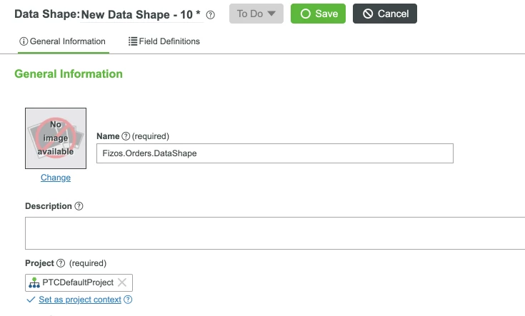

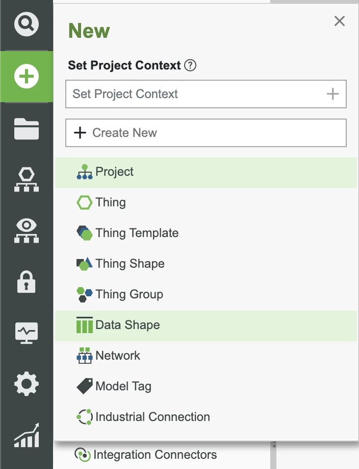

  1. In the ThingWorx Composer, click the + New in the top left of the screen.
  2. Select Data Shape in the dropdown.
  3. In the name field, enter Fizos.Orders.DataShape and select a Project (ie, PTCDefaultProject). All of our orders will be based off this Data Shape.
  4. Click Save then Edit to store all changes now.

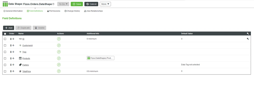

  5. Add the list of properties below:
NameBase TypeAspectsDescription
IDInteger0 minimum, primary key, default 0Row identifier
CustomerIdIntegerN/AString used as unique identifer across multiple platforms
TypeStringN/AType of customer (individual or another company)
FactorsTagData TagThis will hold the different type of data points or tags that will help to analyze a customer's order
ProductsInfotableData Shape: Fizos.DataShapes.ProductsList of orders
TotalPriceNumberMinimum 0Price of the order
StatusStringN/AThe current order status (ie, processed, shipped, completed, etc)
CompletedBooleanN/AWhether the order has been completed
The Properties for the Fizos.Orders.DataShape Data Shape are as follows:

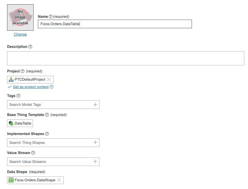

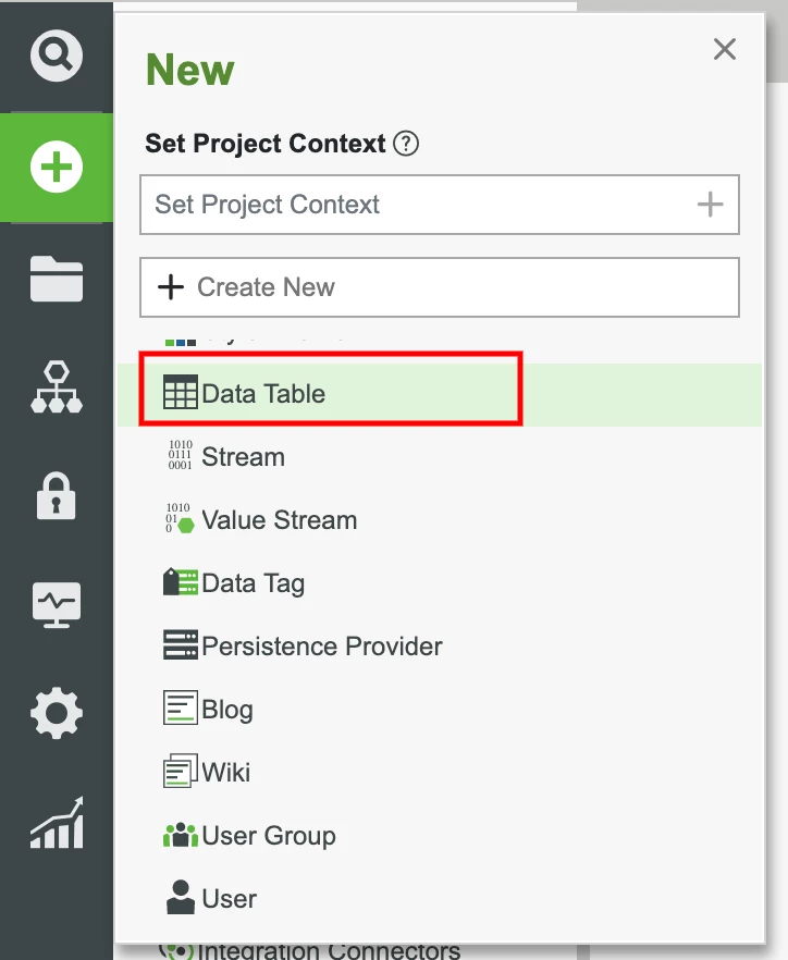

6. In the ThingWorx Composer, click the + New in the top left of the screen.
7. Select Data Table in the dropdown and select Data Table in the prompt.
8. In the name field, enter Fizos.Orders.DataTable. Our differing types of customers will fall under this template.
9. For the Data Shape field, select Fizos.Orders.DataShape and select a Project (ie, PTCDefaultProject).
10. Click Save then Edit to store all changes now.
11. This Entity will be used to house our data and provide assistance with our analytics.

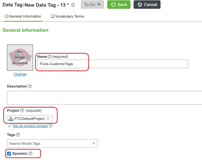

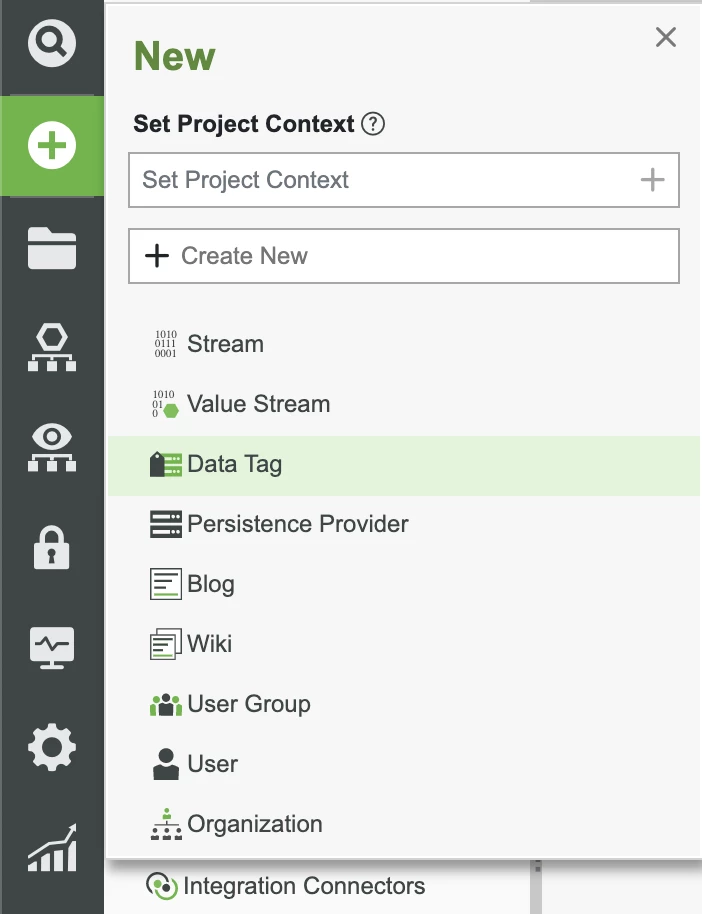

  2. Select Data Tag in the dropdown.
  3. In the name field, enter Fizos.CustomerTags and select a Project (ie, PTCDefaultProject).
  4. Check the Dynamic checkbox. This allows for new vocabulary terms to be created during runtime.
  5. Click on the Vocabulary Terms tab, and add the following terms and then add as many more as you see fit:
