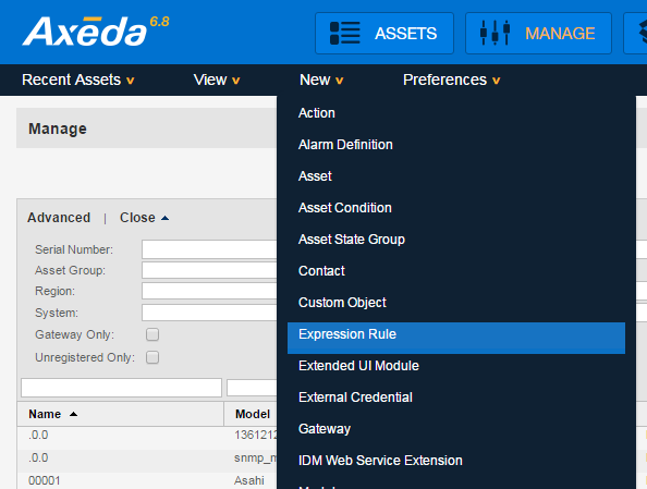

To begin, log into an Axeda Platform instance.
Navigate to the Manage tab
Select ​New​, then ​Expression Rule​

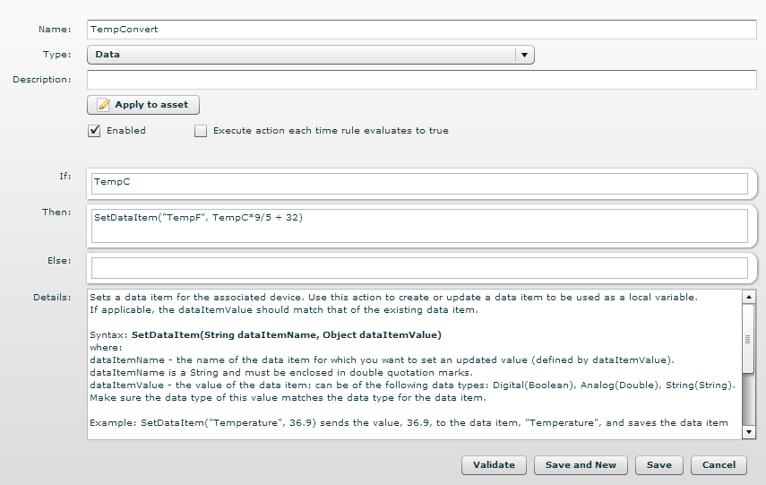

Enter this Expression Rule information
Type: Data
Description:
Enabled
: Leave checked
If: TempC
Then: SetDataItem("TempF", TempC*9/5 + 32)
If you click on functions or scroll down for actions in the Expression Tree, you will see a description in Details.
Click the Apply to Asset​ button to select models and specific assets to apply this rule to.
