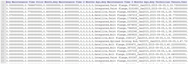

Checking data formats
The analysis starts with a raw data file. The user needs to make sure that the data files can be read.
Raw data files come in many different shapes and sizes. For example, spreadsheet data is formatted differently than web data or Sensors collected data and so forth.
In ThingWorx Analytics the Data Format acceptable are CSV. So the Data retrieved needs to be inputted into that format before it could be uploaded to TWA
Data Example (BeanPro dataset used):

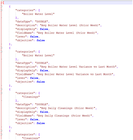

Creating a Data Dictionary
A data dictionary is a metadata description of the features included in the Dataset when displayed it consists of a table with 3 columns:
- The first column represents a label: that is, the name of a feature, or a combination of multiple (up to 3) features which are fields in the used Dataset. It points to “fieldname” in the configuration json file.
- The second column is the Datatype value attached to the label. (Integer, String, Datetime…). It points to “dataType” in the configuration json file.
- The third column is a description of the Feature related to the label used in the first column. It points to “description” in the configuration json file.
In the context of TWA this Metadata is represented by a Data configuration “json” file that would be uploaded before even uploading the Dataset itself.
Sample of BeanPro dataset configuration file below:

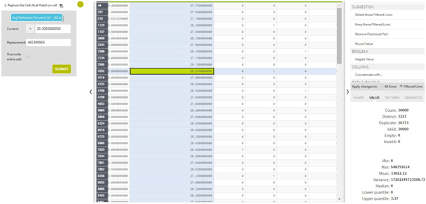

Identifying outliers
Outliers are data points that are distant from the rest of the distribution. They are either very large or very small values compared with the rest of the dataset.
Outliers are problematic because they can seriously compromise the Training Models that TWA generates.
A single outlier can have a huge impact on the value of the mean. Because the mean is supposed to represent the center of the data, in a sense, this one outlier renders the mean useless.
When faced with outliers, the most common strategy is to delete them.

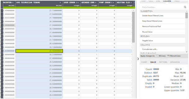

Example of the effect of an Outlier in the Feature “AVG Technician Tenure” in BeanPro Dataset:
  Dataset with No Outlier:
Dataset with Outlier:
