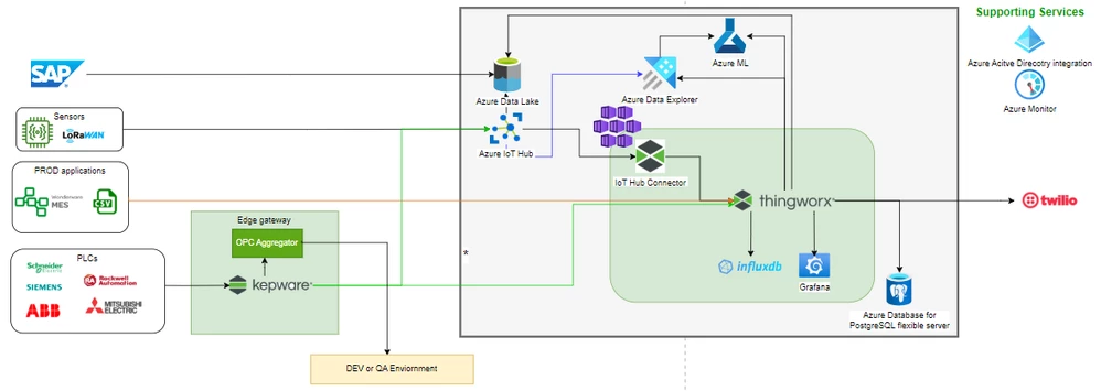

Technical Architecture and Implementation Details
This section combines detailed technical descriptions with the overall reference architecture. It describes the core components, integration points, and implementation strategies that deliver a robust IIoT solution for the customer.
A. Architecture Overview Diagram
High-level architecture diagram for the final solution
B. Detailed Technical Components
Component
Role
Key Features
OPC Aggregators & Kepware
Stream and bridge machine data from production, DEV, and QA environments to Azure IoT Hub for real-time processing in ThingWorx.
Scalable ingestion; latency monitoring; secure device connectivity; segregated closed environments for DEV/QA.
Azure IoT Hub
Ingests and secures machine telemetry data for analytics.
Centralized data ingestion; integration with Azure services.
ThingWorx on VMs
Hosts the core IIoT application that processes data, provides end-user applications, and manages workflows.
High performance; disaster recovery via VM snapshots; enhanced security through Azure AD integration and SSL support.
Managed PostgreSQL
Provides high availability for persistent application data through replication and failover.
Data redundancy; managed service benefits; automated backup and recovery.
Azure Data Explorer / Influx DB
Handles advanced analytics, timeseries visualization, and predictive insights for telemetry data.
Real-time analytics; anomaly detection; cost-effective long-term storage.
Monitoring & Logging Tools
Ensure comprehensive observability and prompt incident response across all components.
Real-time applications monitoring; alerting; centralized log aggregation.
RESTful APIs
Enable seamless integration with ERP systems, legacy data sources, and other IoT devices.
Secure data exchange; standardized connectivity protocols.
