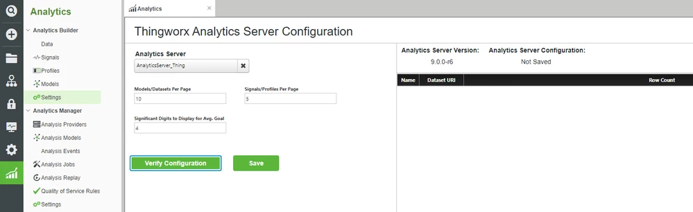

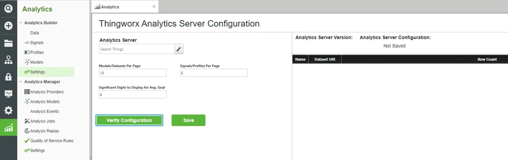

  1. On the ThingWorx Composer Analytics tab, click ANALYTICS BUILDER > Settings.

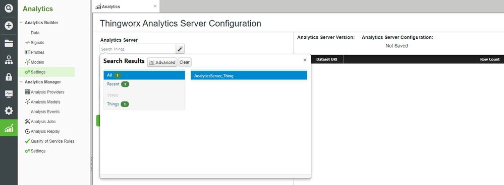

  2. In the Analytics Server field, search for and select your Server Thing Entity, such as AnalyticsServer_Thing or localhost-AnalyticsServer.
  3. Click Verify Configuration.

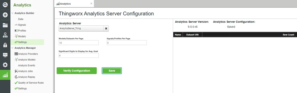

  4. Click Save.
WARNING: You MUST CLICK SAVE or the configurations will be lost when you move to Data in the next step.

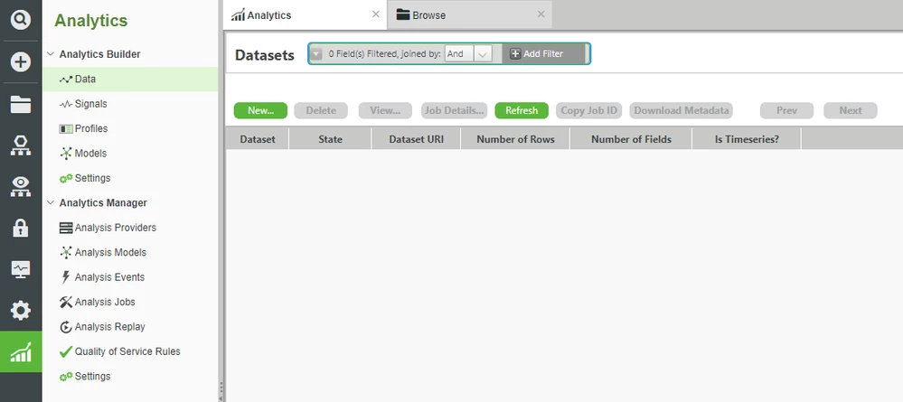

  3. On the left, click ANALYTICS BUILDER > DATA.

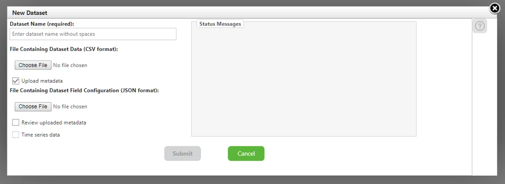

  4. Under Datasets, click New....
    • The New Dataset pop-up will open.

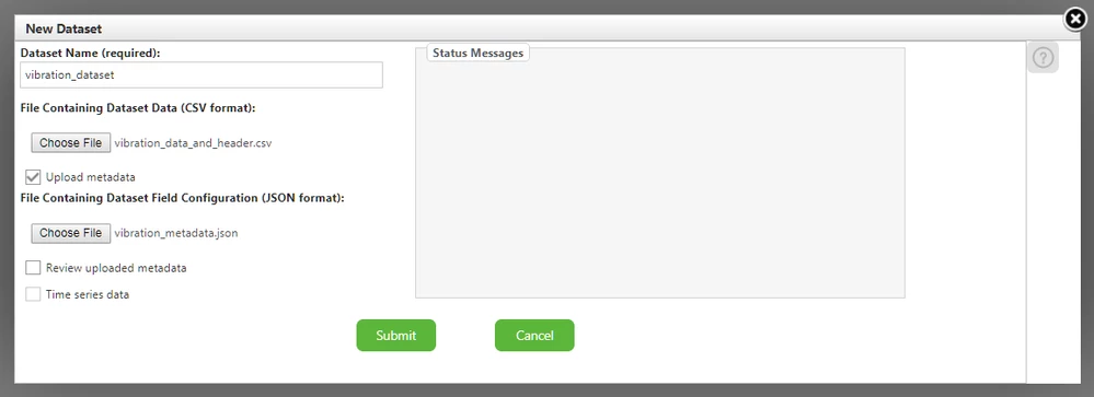

5. In the Dataset Name field, enter vibration_dataset.
6. In the File Containing Dataset Data section, search for and select vibration_data_and_header.csv.
7. In the File Containing Dataset Field Configuration section, search for and select vibration_metadata.json.
8. Click Submit.

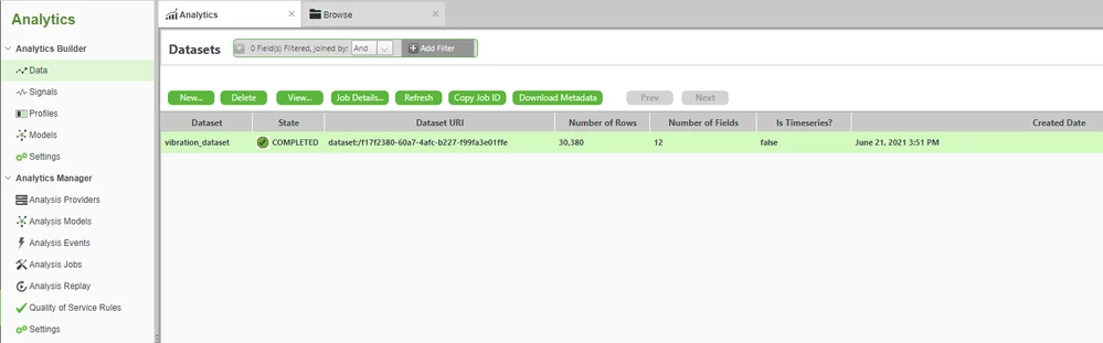

    • Note that it will take a variable amount of time for the data-upload to complete, based on the size of your dataset.

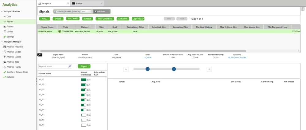

Step 4: Signals
The Signals section of ThingWorx Analytics looks for the most statistically correlated single field in the dataset which relates to your selected goal. This doesn't necessarily indicate that it is the cause of your goal, whether maximizing or minimizing. It just means that the dataset indicates that this single field happens to correlate with the goal that you desire.

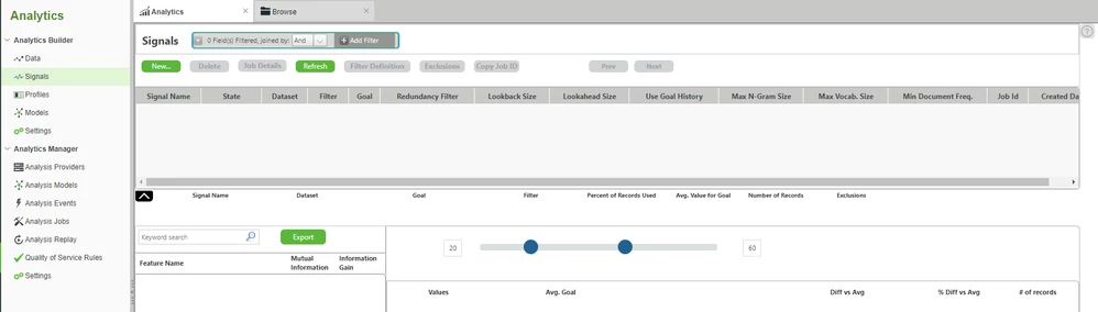

  1. On the left, click ANALYTICS BUILDER > Signals.

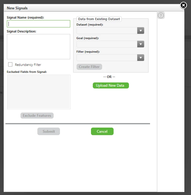

  2. At the top, click New….
    • New Signals pop up will open.

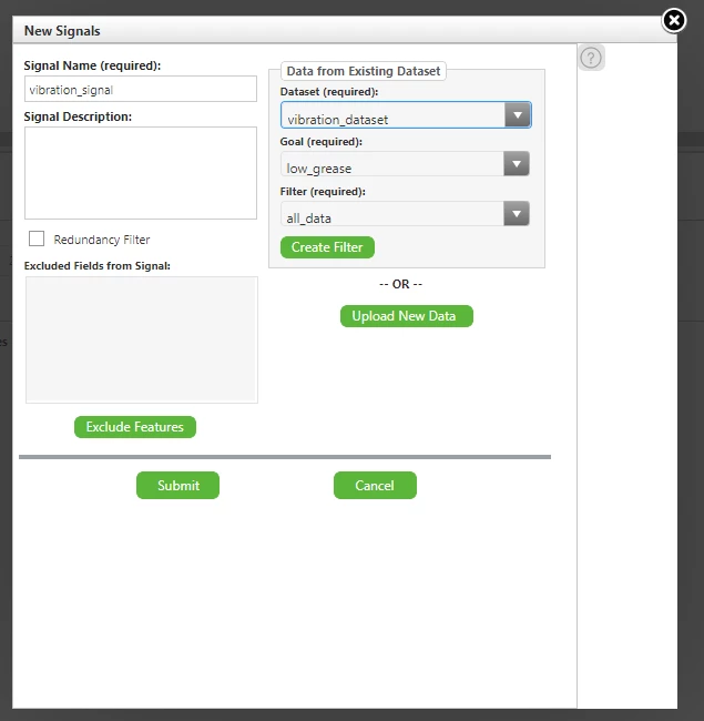

3. In the Signal Name field, enter vibration_signal.
4. In the Dataset field, select vibration_dataset.
5. Leave the Goal field set to the default of low_grease.
6. Leave the Filter field set to the default of all_data.
7. Leave the Excluded Fields from Signal field set to the default of empty.

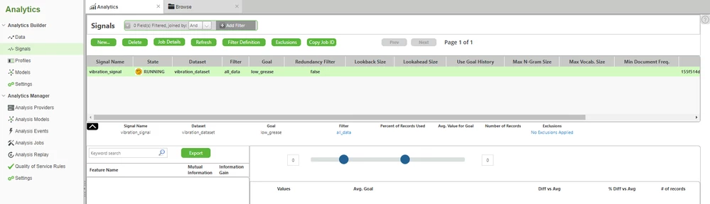

8. Click Submit.
9. Wait ~30 seconds for Signal State to change to COMPLETED
    • The results will be displayed at the bottom.
The results show that the five Frequency Bands for Sensor 1 are the most highly correlated with determining our goal of detecting a low grease condition. For Sensor 2, only bands one and four seem to be at all related, and bands two, three, and five are hardly related at all.
