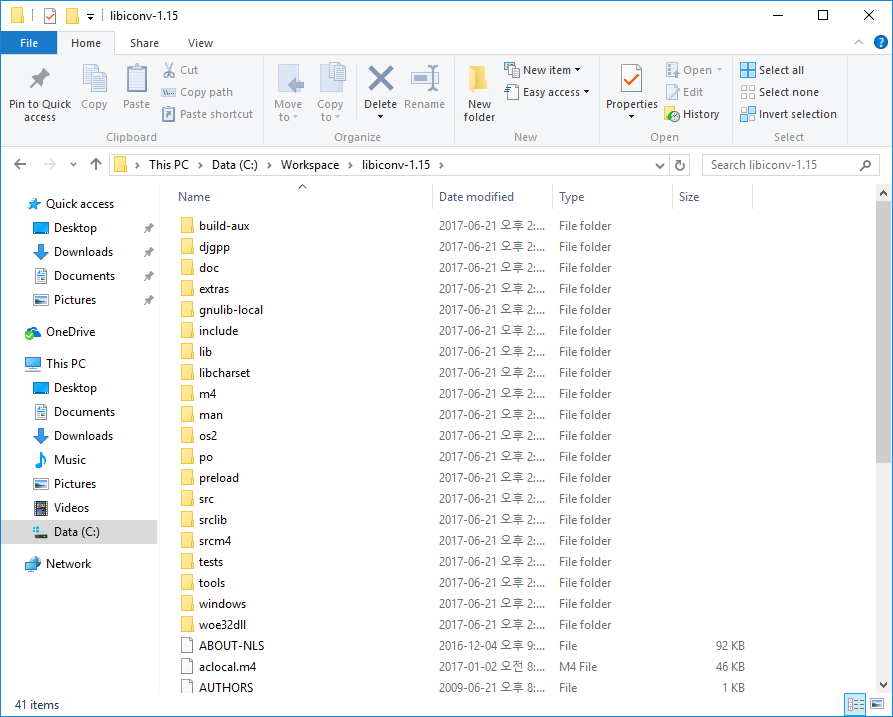

Step 1. Download the most recent version of libiconv and unzip the file.

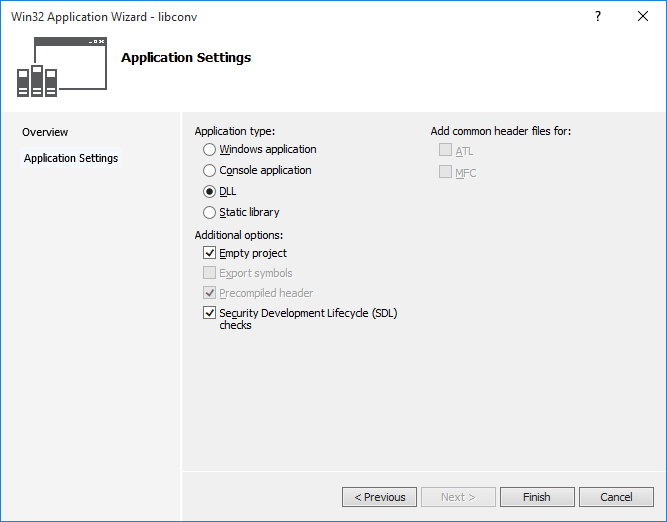

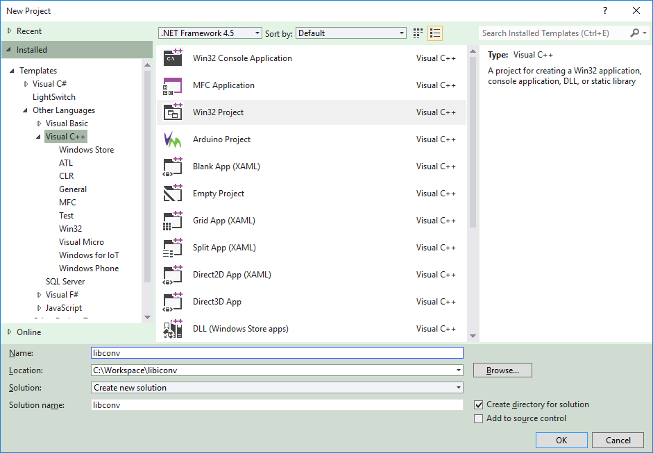

Step 2. Make a new Win32 Project.
Let's say "libiconv" as the project name. Check to create directory for solution.
Choose DLL as the application type and check Empty Project for additional options. Click the button "Finish" to generate the new project.
Step 3. Copy files from the folders of libiconv to project folders.
To build "libiconv", you need to compile three files "localcharset.c", "relocatable.c" and "iconv.c". That's the key!
  1. Copy three files "relocatable.h", "relocatable.c" and "iconv.c" in the folder "...\libiconv-1.15\lib\" to the project folder "...\libiconv\libiconv\".
  2. Copy "...\libiconv-1.15\libcharset\lib\localcharset.c" to the project folder "...\libiconv\libiconv\".
  3. Copy "...\libiconv-1.15\libcharset\include\localcharset.h.build.in" to the project folder "...\libiconv\libiconv\" and then, rename the copied "localcharset.h.build.in" to "localcharset.h".

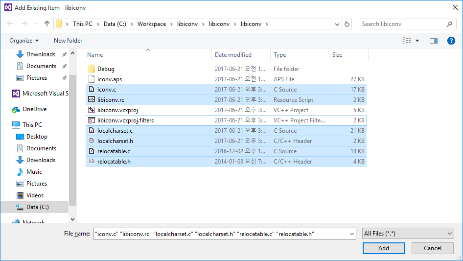

Step 4. Add existing items.
Execute "project > Add Existing items..." at the main menu to add existing items to the project.

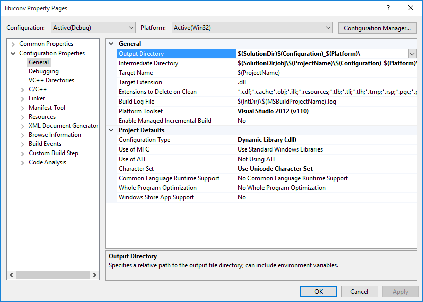

You can make 64-bit platform through configuration manager in order to generate libiconv.dll for 64-bit system. You can also make two other configurations "ReleaseStatic" and "DebugStatic" in order to generate libiconvStatic.lib as a static link library.
At the project properties, change Output Directory as "$(SolutionDir)$(Configuration)_$(Platform)\" and Intermediate Directory as "$(SolutionDir)obj\$(ProjectName)\$(Configuration)_$(Platform)\".

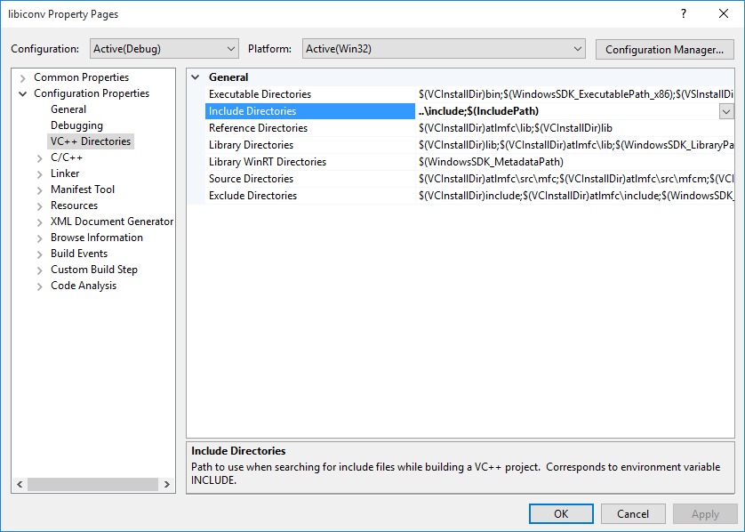

Change Include Directories as "..\include;$(IncludePath)":

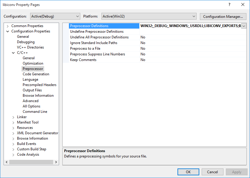

You have to add "BUILDING_LIBICONV" and "BUILDING_LIBCHARSET" to Peprocessor Definitions of all Platforms and of all configurations.

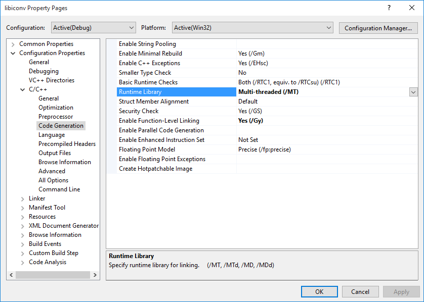

You'd better set Runtime Library to "Multi-threaded" when building dynamic link library libiconv.dll. Then, the dependency on VC Runtime library can be controlled by the applications that will be built and dynamically linked with libiconv.dll because libiconv.dll does not need VC Runtime library but only the application that uses libiconv.dll may or may not need VC Runtime library. However, when building the static link library libiconvStatic.lib, you can choose Runtime Library option for libiconvStatic.lib depending on the application that uses libiconvStatic.lib.

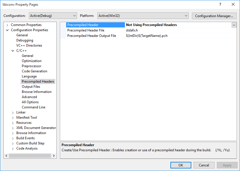

You have to change Precompiled Header option to "Not Using Precompiled Headers".
