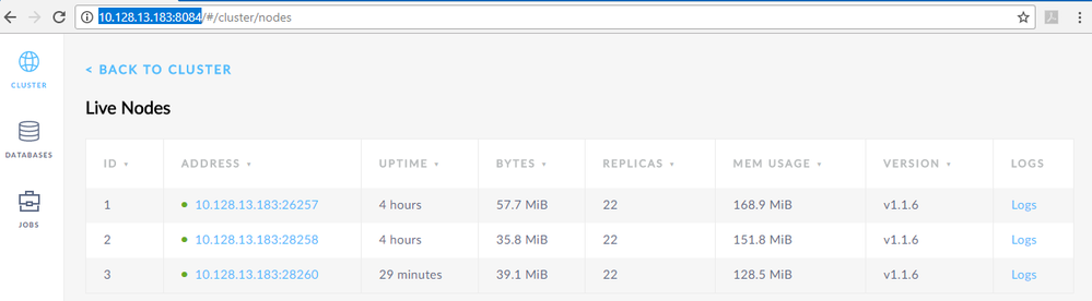

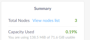

Verifying the live cluster and nodes via the web based CockroachDB admin console
  • Open a web browser with any of the above node's http-port e.g. http://10.128.13.183:8084
  • Click on the View nodes list on the right panel
  • This will open the nodes list page

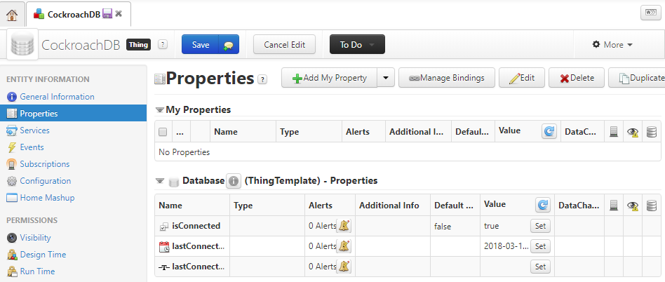

  • Create a Thing based of Database Thing Template
  • Use following connection settings:
JDBC Driver Class Name : org.postgresql.Driver
JDBC Connection String	: jdbc:postgresql://<serverIp/name>:26257/thingworx?sslmode=disable
Database User Name	: cockroach
Database password : <password>
  • Navigate to the Properties to verify the connectivityimage

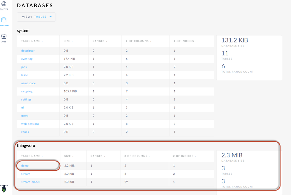

Verifying the Database & a table created within that DB via the web admin console of CockroachDb
Under the left panel click on the Databases from the home page of one of the node's web admin consloe e.g. http://localhost:8084
Apart from other useful information about the database e.g. the database size and total number of tables, etc., clicking on the table name will also show the sql used to create it (including the defaults).

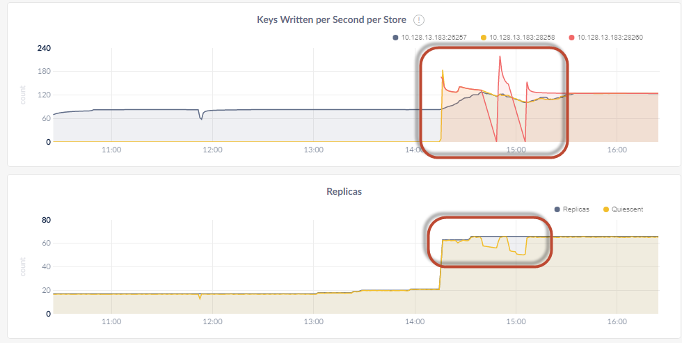

At this point different users in ThingWorx with sufficient access rights can create their DB Things in ThingWorx Composer and can use any of the node address to read/write the data to the CockroachDB cluster. For the purpose of demo one node was stopped while other 2 were running and data was written to the clsuter via the test service created above. Once the 3rd node was restarted we can see the automatic replication happening between the nodes; this can be seen live via the web based admin console of any of the running node's web console.
As highlighted above at certain point in time after i.e 1500hrs all nodes were synced with the data, including the node3 ,which as mentioned above was down while data was being inserted to the cluster. All of the above replication process was done using default configuration.
