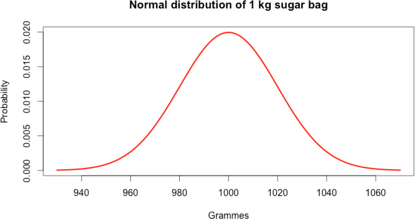

Example
When a factory is making 1 kg sugar bags it doesn’t always produce exactly 1 kg. In reality, it is around 1 kg. Most of the time very close to 1 kg and very rarely far from 1 kg.
Indeed, the production of 1 kg sugar bag follows a normal distribution.

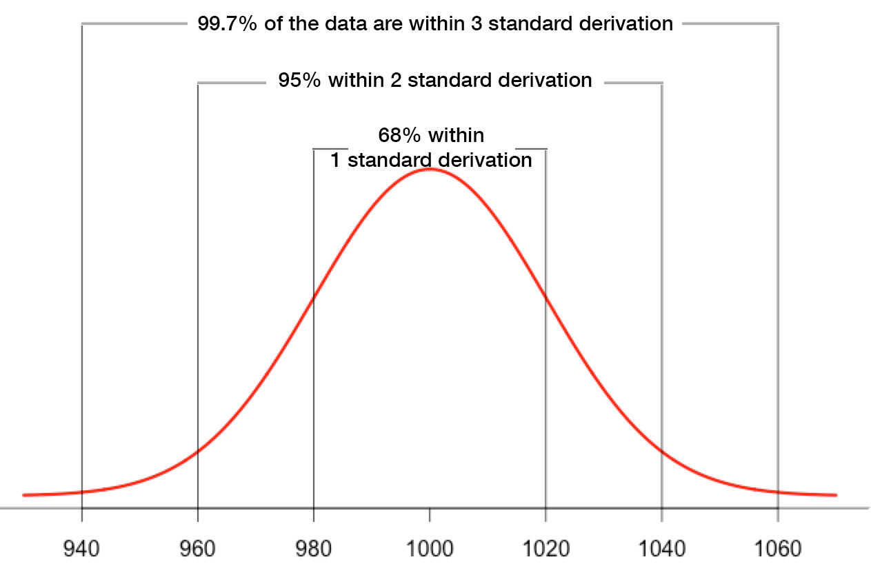

Mathematical rules
When a metric appears to be normally distributed it follows some interesting law. As does the sugar bag example.
The mean and the median are the same. Both are equal to 1000. It’s because of  the perfectly symmetric “bell-shape”
It is the standard deviation called sigma σ that defines how the normal distribution is spread around the mean. In this example σ = 20
68% of all values fall between [mean-σ; mean+σ]
For the sugar bag [980; 1020]
95% of all values fall between [mean-2*σ; mean+2*σ]
For the sugar bag [960; 1040]
99,7% of all values fall between [mean-3*σ; mean+3*σ]
For the sugar bag [940; 1060]
The last 3 rules are also known as the 68–95–99.7 rule also called the three-sigma rule of thumb

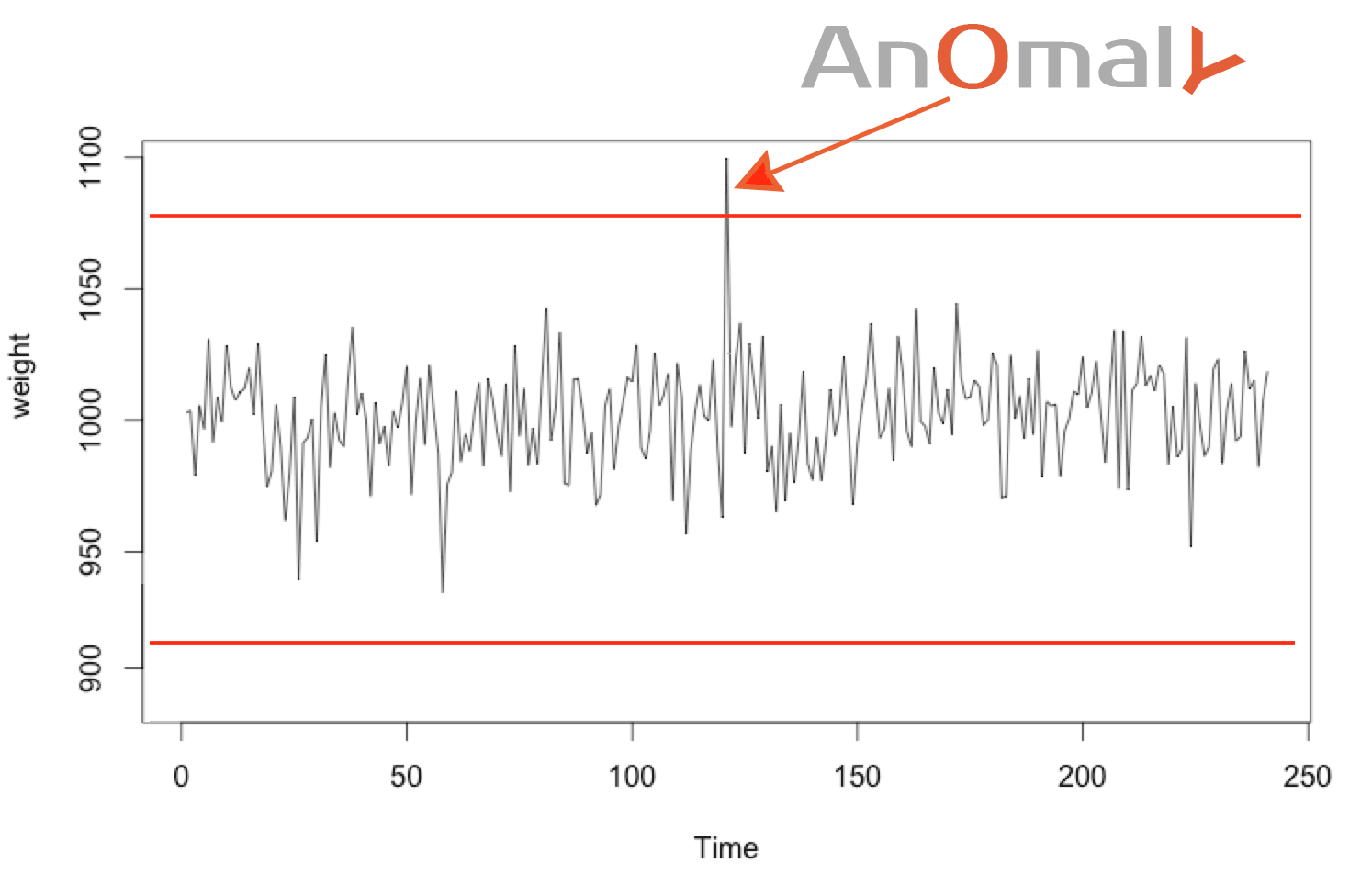

Technique n°1: outlier value
An almost impossible value could be considered as an anomaly.
When the value deviates too much from the mean, let’s say by ± 4σ, then we can consider this almost impossible value as an anomaly. (This limit can also be calculated using the percentile).
Sugar bags who weigh less than 920 g or more than 1080 g are considered anomalous. Chances are, there is a problem in the production chain.
This provides a simple way to define maximum and minimum thresholds.

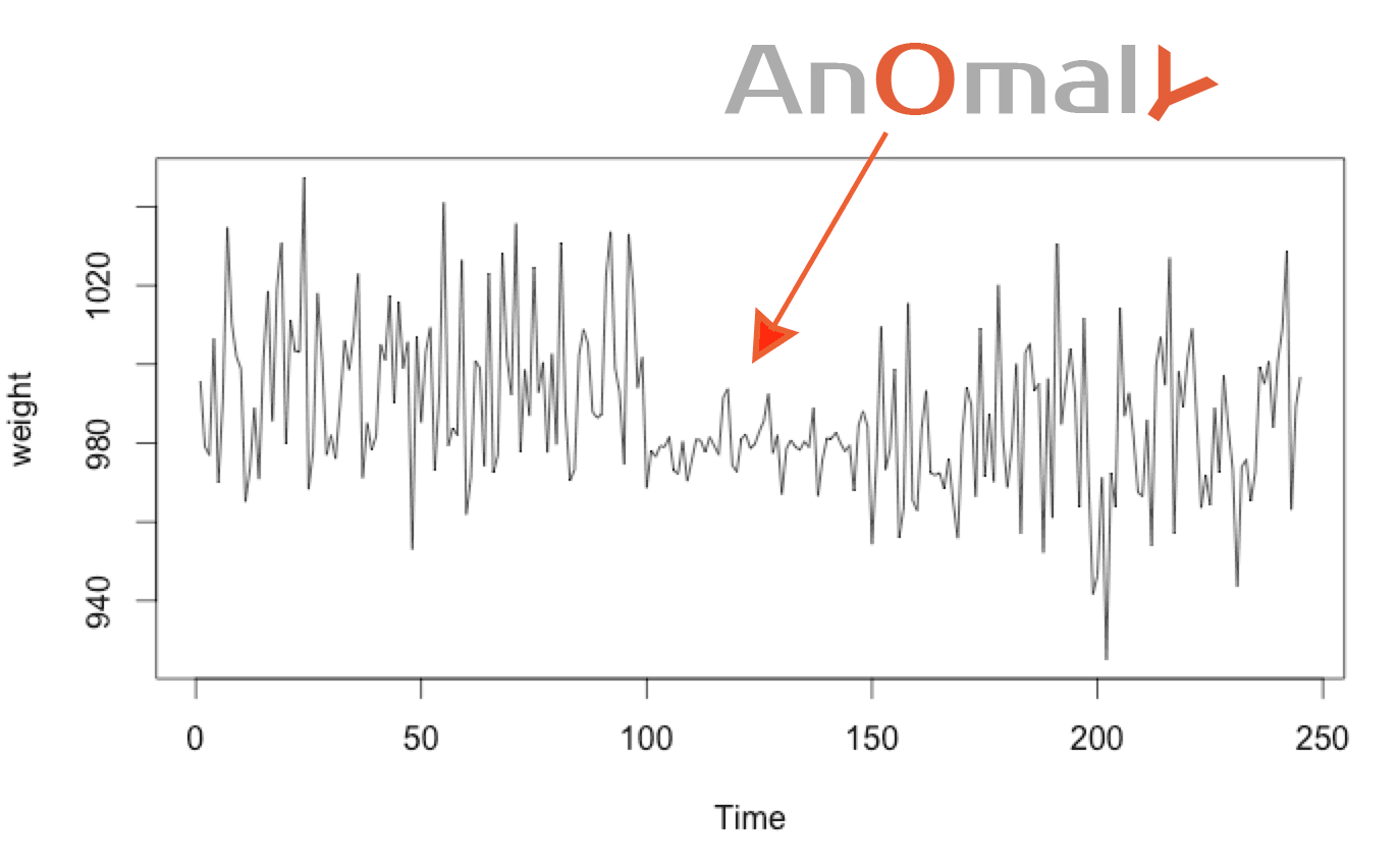

Technique 2: detecting change in the normal distribution
Technique n°2 can detect unusual distribution fast, using only some points. But it can’t detect anomalies who move from one sigma σ to another in a usual manner.
To detect this kind of anomaly we use a “window” of n last elements.
If the mean and standard derivation of this window change too much from usual then we can deduce an anomaly. Using a big window with a lot of values is more stable, but it requires more time to detect the anomaly.
The bigger the window is the more stable it becomes. But it would require more time to detect the anomaly as it needs to aggregate more values for the detection.
