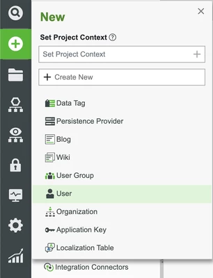

  1. In the ThingWorx Composer, click the + New at the top of the screen.
  2. Select User in the dropdown.

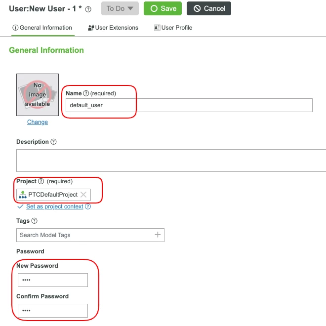

  3. Name the User default_user and add a password.
  4. Set the Project field (ie, PTCDefaultProject) and click Save.

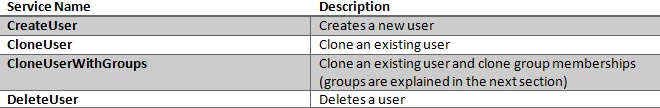

User-Related Services
There are a few Services available through a resource called EntityServices, that allow you to interact with user entities programmatically.

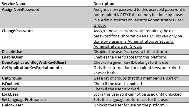

Once a user has been created, you can interact with it through some built-in Services:

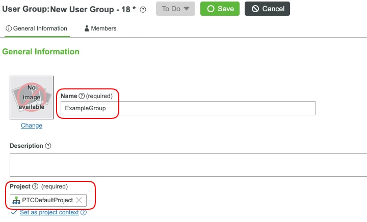

Create Group and Add Users

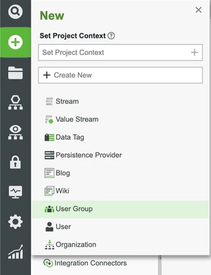

  2. Select User Group in the dropdown.
  3. Name your group ExampleGroup.

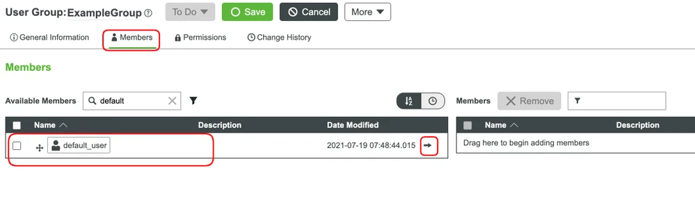

  5. Click Members to view current members in the group.
  6. Filter and select the user you want to add in the Available Members section.
  7. Click the arrow on their row or drag the User to the Members section.
  8. Click Save.
