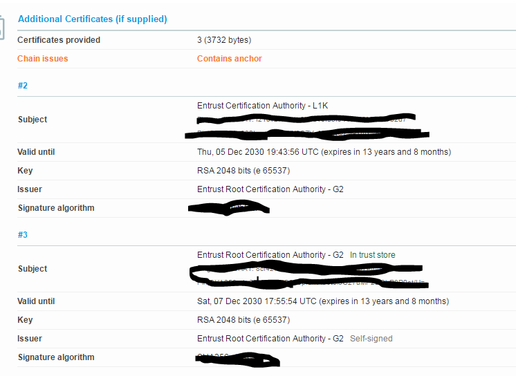

  • When using Entrust certificates, obtained at https://www.entrust.com/get-support/ssl-certificate-support/root-certificate-downloads/ , how do we know that the certifactes are fed to the WSEMS configuration incorrectly?
    • With the wrong configuration, WSEMS would error out rejecting the Entrust certificate:
      • Non-fips Error code 20: Invalid certificate
      • Fips: Error code 19:  self signed certificate in certificate chain
  • How to properly install Entrust certificate to be accessed by EMS?
    • Public certificate needs to be downloaded and put in a directory that is accessible to the EMS. The path to be added to the cert chain field of the configuration.
    • Even if its trusted it will always need to be installed on the EMS. If a certificate is self-signed, meaning it's non-trusted by default, OpenSSL would throw errors and compain. To solve this, it needs to be installed as a trusted server. If it's signed by a non-trusted CA, that CA's certificate needs to be installed as well.
    • Once the certificates are obtained this if the block of the configuration we are interested in:
"certificates":    {
                  "validate":          true, //Not validated model is not recommended
                      "allow_self_signed":  false, //Self signed model is not recommended, yet theoretically better than non-validated
                      "cert_chain":      " " } //recommended, trusted - also the only way to work with a FIPS enabled EMS
    • May use the SSL test tool (for example,https://www.ssllabs.com )to find all chains. For Entrust, both Entrust L1k and G2 need to be downloaded:
    • Because cert_chain is an array type of field, the format to install the certificates paths, would be: "cert_chain": ["path1"], ["path2"]
      • "cert_chain": ["C:\\ThingworxLocation\\MicroServerLocation\\locationofcertificates\\entrust_l1k.pem","C:\\ThingworxLocation\\MicroServerLocation\\locationofcertificates\\entrust_g2_ca.pem"]
