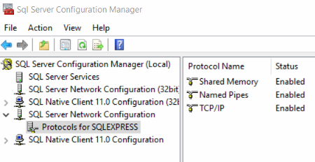

2. Once installed, it's imperative that the TCP/IP Protocol is enabled in the SQL Server Configuration Manager for the SQL Server

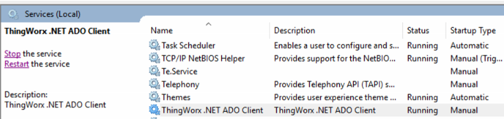

12. Navigate to the windows services by opening Windows Start > Run > services.msc
13. Check for the service ThingWorx .NET ADO Client as you'll have to start it if it's set to Manual, like so in my case
Following message will be logged on successful connection  in the
DotNETSDK -X-X-X.log : [Critical] twWs_Connect: Websocket connected!

- Service is not able to successfully reach or authenticate against the SQL Server Express DB instance
- Ensure that the TCP/IP is enabled for the Protocols for the SQL Express, as I have shared in the screenshot above
- Make sure that the username / password used for authenticating with the database is correctly provided while configuring the settings for the OLEDB section in    AdoThing.config
