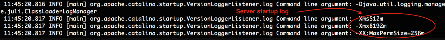

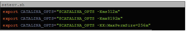

But the best and recommended way is to use setenv.sh/setenv.bat (Linux/Windows respectively). It isn't in the as-downloaded Tomcat. But if you look in catalina.sh/catalina.bat, there's a check for a file called setenv. If it's there, it's run. That's where you set JAVA_OPTS, CATALINA_OPTS, etc. We use it to set JAVA_HOME, JAVA_OPTS, CATALINA_OPTS and JPDA_ADDR. Putting all your environment variables into this file is ideal because then you don't have to change the stock startup scripts.
Then when monitoring the log we can see the parameters taken:
