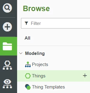

  1. In ThingWorx Foundation Composer, click Browse.
  2. On the left, click Modeling -> Things.
  3. Click + NEW.

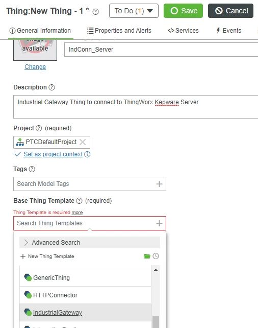

  4. In the Name field, enter IndConn_Server, including matching capitalization.
  5. If Project is not already set, click the + in the Project text box and select the PTCDefaultProject.
  6. In the Description field, enter an appropriate description, such as Industrial Gateway Thing to connect to ThingWorx Kepware Server.
  7. In the Base Thing Template field, enter indus, then select the IndustrialGateway Thing template from the sorted list.
  8. Click Save.

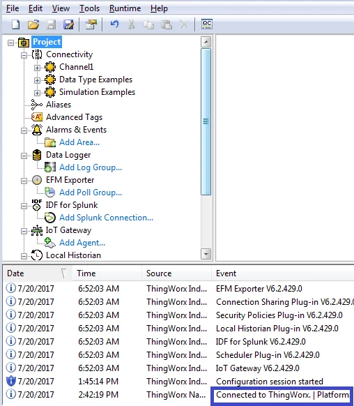

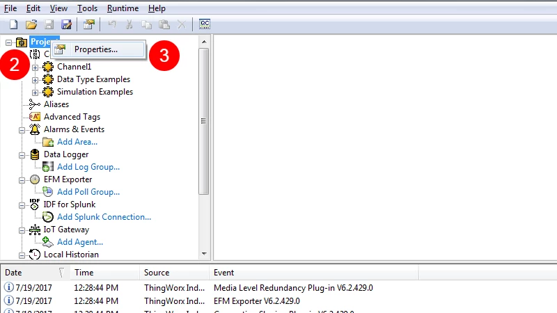

  1. Return to the ThingWorx Kepware Server Windows application.
  2. Right-click Project.
  3. Select Properties….

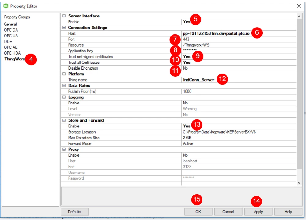

      4. In the Property Editor pop-up, click ThingWorx.
      5. In the Enable field, select Yes from the drop-down.
      6. In the Host field, enter the URL or IP address of your ThingWorx Foundation server, Do not enter http://
      7. Enter the Port number. If you are using the "hosted" Developer Portal trial, enter 443.IoTProductMgmt_3-1658879215385.png
8. In the Application Key field, copy and paste the Application Key you just created.
9. In the Trust self-signed certificates field, select Yes from the drop-down.
10. In the Trust all certificates field, select Yes from the drop-down.
11. In the Disable encryption field, select No from the drop-down if you are using a secure port. Select Yes if you are using an http port.
12. Type IndConn_Server in the Thing name field, including matching capitalization.
13. If you are connecting with a remote instance of ThingWorx Foundation and you expect any breaks or latency in your connection, enable Store and Forward.
14. Click Apply in the pop-up.
15. Click Ok.
In the ThingWorx Kepware Server Event window at the bottom, you should see a message indicating Connected to ThingWorx.
NOTE: If you do not see the "Connected" message, repeat the steps above, ensuring that all information is correct. In particular, check the Host, Port, and Thing name fields for errors.

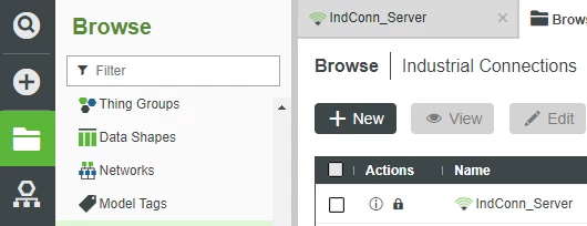

  1. Return to ThingWorx Foundation.
  2. Click Browse.
  3. Click Modeling -> Industrial Connections.IoTProductMgmt_5-1658879215388.png
  4. Click IndConn_Server.

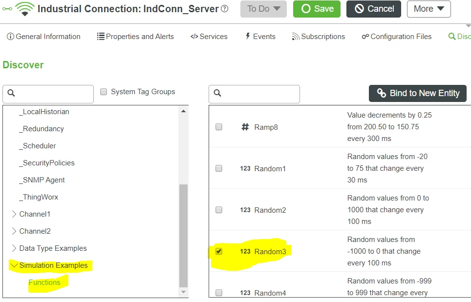

  5. At the top, click Discover.
    • The Discover option is exclusive to Things inheriting the IndustrialGateway Thing Template and displays information coming from ThingWorx Kepware Server.
      Create New Thing Step 4 Step 5.png       6. Expand Simulation Examples.
       7. Click Functions. On the right, you’ll see several pre-defined Tags to assist with connectivity testing.
       8. Click the checkbox next to Random3.
       9. Click Bind to New Entity.

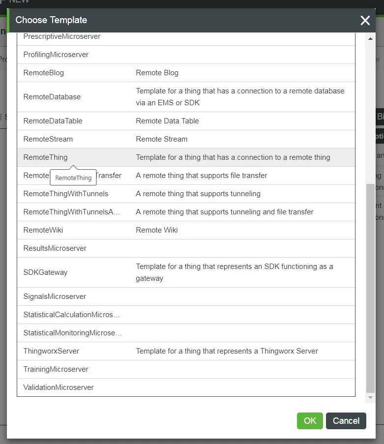

      10. In the Choose Template pop-up, select RemoteThing and click OK.

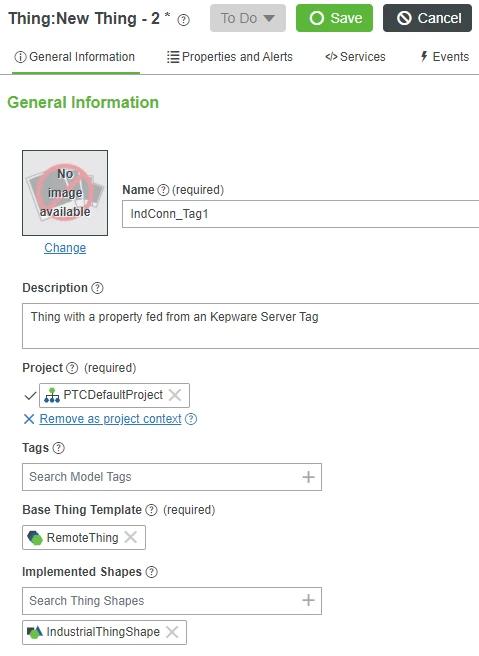

You’ll now be in an interface to create a new Thing with a predefined Property based on ThingWorx Kepware Server Tag1.
  1. Type IndConn_Tag1 in the Name field.
  2. If Project is not already set, click the + in the Project text box and select the PTCDefaultProject.
  3. In the Description field, enter an appropriate description, such as Thing with a property fed from an Kepware Server Tag.
    • The Base Thing Template has been automatically set to RemoteThing.
    • The Implemented Shapes has been automatically set to IndustrialThingShape.
4. Click Save.

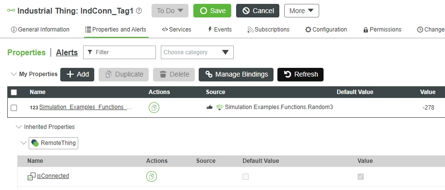

  1. At the top, click Properties and Alerts.
    • Under Inherited Properties, you will see entries for both RemoteThing and IndustrialThingShape.
    • The Property isConnected is checked, indicating a connection from Foundation to ThingWorx Kepware Server.
    • The Property IndustrialThing has been automatically set to IndConn_Server.
  2. Notice the predefined Property named Simulation_Examples_Functions_Random3.IoTProductMgmt_10-1658879215398.png
  3. Click Refresh repeatedly.
    • You’ll see the value increase with each Refresh. This represents data being simulated in ThingWorx Kepware Server.
