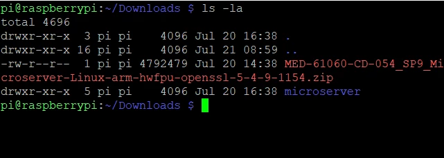

- After downloading the EMS zip file, unzip the archive in a suitable location on the Pi using the command below. Use the Tab key to automatically complete file names.
unzip /MED-61060-CD-054_SP9_Microserver-Linux-arm-hwfpu-openssl-5-4-10-1509.zip
After unzipping the distribution, a sub-directory named /microserver will be created inside the parent directory.

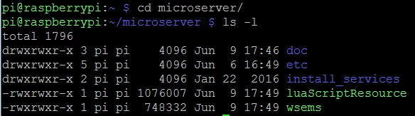

- Verify that microserver directory was created with the command ls -l
Switch into the microserver directory with the command cd microserver The microserver directory includes the following files.
File Name Description
| wsems | An executable file that runs the Edge MicroServer |
| luaScriptResource | The Lua utility that is used to run Lua scripts, configure remote things, and integrate with the host system |

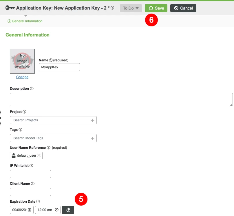

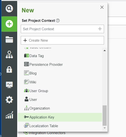

Step 3: Create Application Key

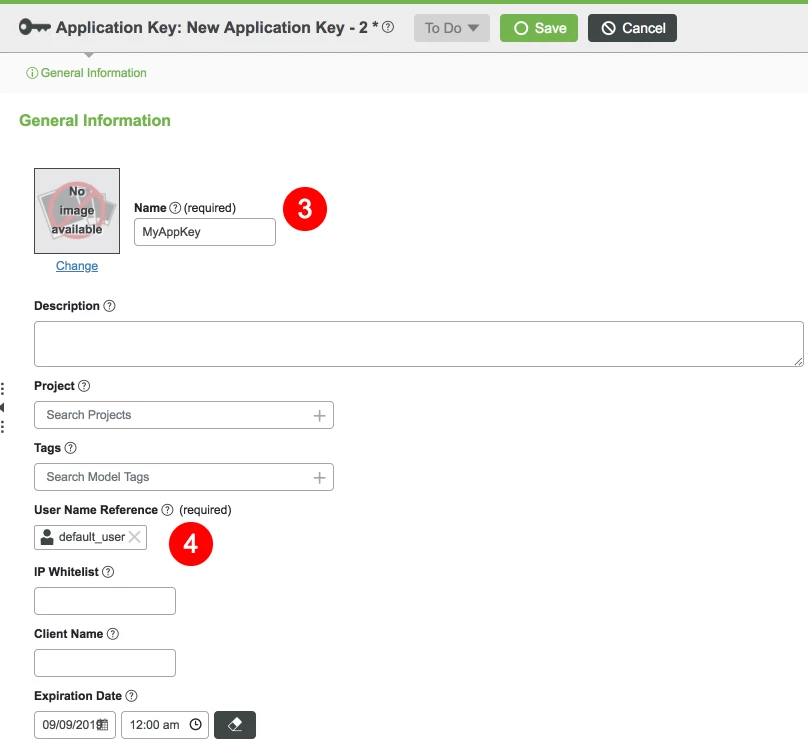

In this step, you will be using the ThingWorx Composer to generate an Application Key. The Application Key will be used to identify the Edge Agent. The Application Key is tied to a user and has the same entitlements on the server.
Using the Application Key for the default User (Administrator) is not recommended. If administrative access is absolutely necessary, create a User and place the user as a member of the SecurityAdministrators and Administrators User Groups.
Create the User the Application Key will be assigned to.

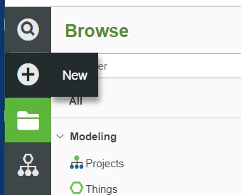

On the Home screen of Composer click + New.
In the dropdown list, click Applications Key.
- Give your Application Key a name (ie, MyAppKey).
Set the User Name Reference to a User you created.
- Update the Expiration Date field, otherwise it will default to 1 day.
- Click Save.

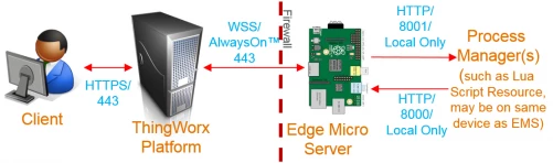

The EMS consists of two distinct components that do slightly different things and communicate with each other. The first is the EMS which creates an AlwaysOn™ connection to the ThingWorx server. It binds things to the platform and automatically provides features like file transfer and tunneling.
The second is the Lua Script Resource (LSR). It is used as a scripting language so that you can add properties, services, and events to the things that you create in the EMS. The LSR communicates with your sensors or devices. The LSR can be installed on the same device as the EMS or on a separate device. For example, one LSR can be a gateway and send data from several different things to a single EMS.

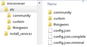

- Change directory to microserver/etc.
cd microserver/etc
- Create a config.json file.
- EMS comes with two sample config files that can be used as a reference for creating your config.json file. The config.json.minimal file provides minimum and basic options for getting started. The config.json.complete provides all of the configuration options.
- Create the config.json file in the etc folder.
sudo nano config.json

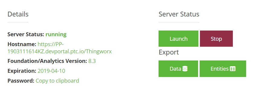

- ws_servers - host and port address of the server hosting the ThingWorx Platform. If you are using a Developer Portal hosted server, your server hostname is listed on the dashboard.
