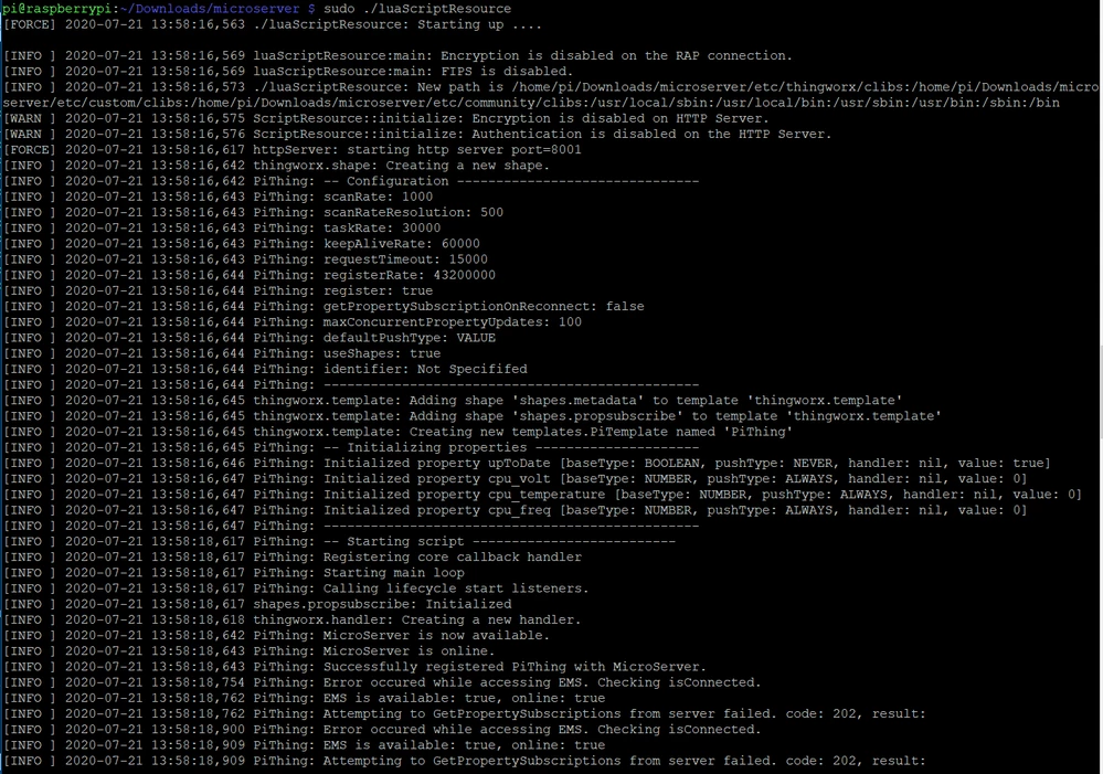

Step 9: Run LSR
1. Navigate from installation directory to microserver directory.
cd microserver
2. Ensure that wsems is running in a separate terminal session before you start running LuaScriptResource.
3. Ensure that you have ownership to the executable luaScriptResource and executable privileges. To check ownership:
Ls -la
 -rwxrwxr-x 1 pi pi 769058 Jun 9 17:46 luaScriptResourc
NOTE: The owner of luaScriptResource should be the user you are logged in as on the Raspberry Pi.
4. Confirm you have executable privileges by running the following command:
sudo chmod 775 luaScriptResource
5. Run LuaScriptResource by executing the following command:
sudo ./luaScriptResource
6. The output will show an error until we create the corresponding Thing in the next step.

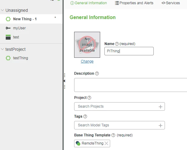

Step 10: Bind Remote Thing Properties
Now we need to register a Thing so your Raspberry Pi can bind to its Properties on the Thingworx Platform.
  1. Create a Thing named PiThing that will bind the scripts.PiThing created in config.lua .
    • Open your Composer screen.
    • Click Things on the left-navigation and the + symbol.
    • Enter PiThing in the Name field and click RemoteThing in the Thing Template field.
    • Click Save.

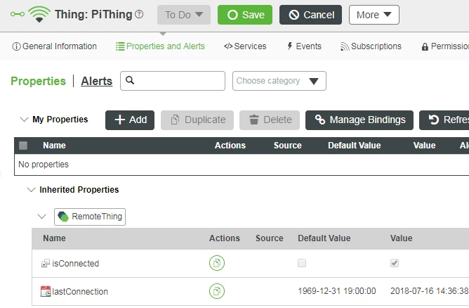

  2. Ensure that the Remote Thing Property is connected.
    • Click Properties in the left-hand navigation.
    • Verify that the isConnected Property has a value of true. This means that your Raspberry Pi is still connected and now bound to this Thing on Thingworx Platform.

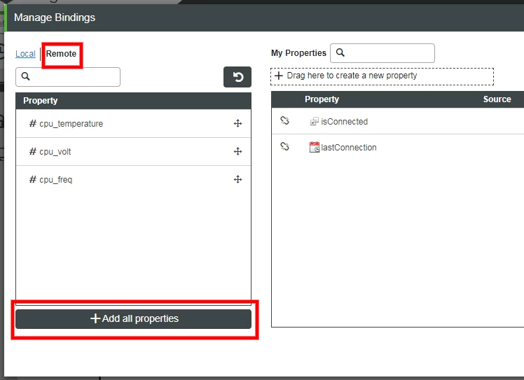

  3. Bind the remote Thing Properties.
    • Make sure the Properties tab is selected and click Edit at the top of the PiThing.
    • Click Manage Bindings.
    • Select the Remote tab at the top.
    • Click Add All Above Properties or drag and drop the ones you need.
    • Click Done.
    • Click Save.

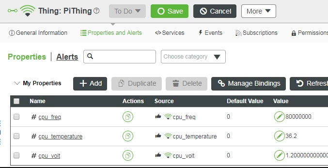

  4. Verify that the Properties were updated with readings from the Raspberry Pi.
    • Both the Value and Default Value for the three Properties will be set to the current reading from the Raspberry Pi.
    • Cover the Raspberry Pi and wait about a minute, then Select the Properties tab and click Refresh. You will see the cpu_temperature value change.
NOTE: The system properties from your Raspberry Pi are now being passed to the server every 30 seconds. Wait a couple of cycles to see if the values from the Raspberry Pi change. If you are impatient, manually change the value of the property using the Set button in the Composer then click Refresh to see the updated value. The value will be temporarily updated for about 30 seconds until the Raspberry Pi reports the current live value.

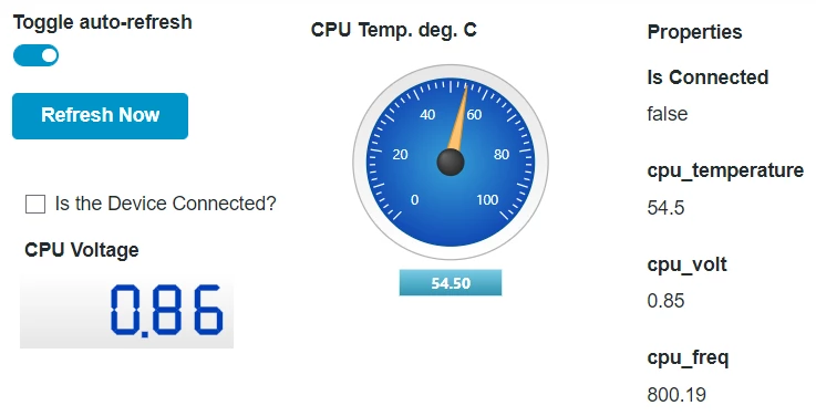

Step 11: View Data from Devices
In order to demonstrate how ThingWorx can render a visualization of data from connected devices, at this point in the lesson you will import a pre-configured Mashup.
  1. On the ThingWorx server that the EMS is connected to, start on the Home tab of Composer.
  2. Import a pre-built Mashup.

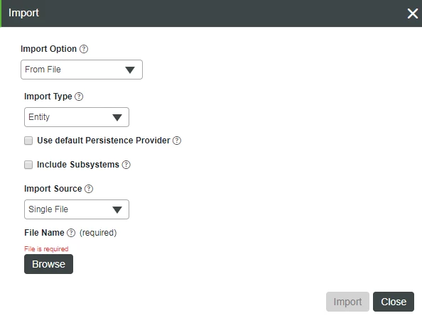

    • Download and save the pre-built Mashup XML file attached here: Mashups_PiThingMashup-v91.xml.
    • In Composer, click the Import/Export drop-down at the bottom-left.
    • Click Import.
    • Leave all default values and click Browse to select the Mashups_PiThingMashup-v91.xml file that you just downloaded.
    • Click Open, then Import, and once you see the success message, click Close.

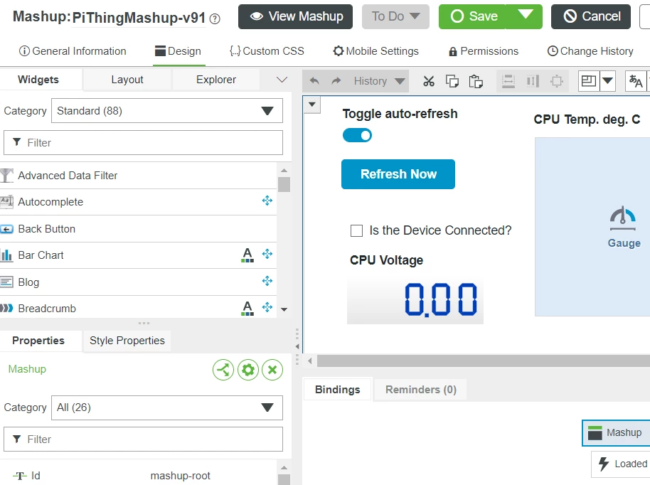

  3. View Mashup displaying live data.
    • Select the home icon in the top left side of Composer, then click Mashups on the left-navigation panel.
    • Click Mashups_PiThingMashup-v91 and you'll see the design view of the Mashup.
    • Click View Mashup, and you'll see the live Mashup.
 TIP: You will need to allow pop-ups in your browser for the Mashup to be displayed.
