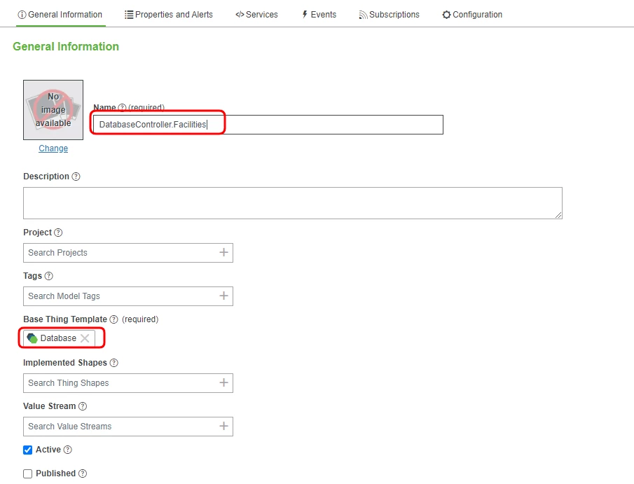

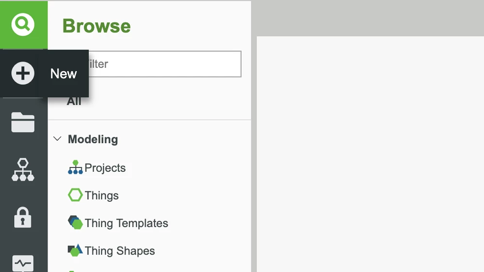

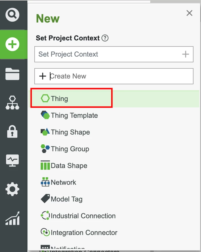

1. In ThingWorx Composer, click the + New at the top-left of the screen.
2. Select Thing in the dropdown.
3. Name the Thing `DatabaseController.Facilities` and select Database as the Base Thing Template.
4.Click Save and go to the Configurations tab.

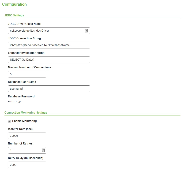

In this tab, you will enter the class name of your driver, the connection string for that database connection, and the credentials to access the database.
Keep in mind, the JDBC Driver Class Name, JDBC Connection String, and the connection Validation String values are all database type specific. For example, to connect to a SQL Server database, the below configuration can be used.
TitleDescription Example
 JDBC Driver Class Name The specific class name of the driver being used for the connection. net.sourceforge.jtds.jdbc.Driver (SQL Server) or oracle.jdbc.driver.OracleDriver (Oracle)
 JDBC Connection String The connection string to locate the database by host/port/database name. jdbc:jtds:sqlserver://server:port/databaseName (SQL Server) or jdbc:oracle:thin:@hostname:port:databaseName (Oracle)
 connectionValidationString A simple query that should always work in a database. SELECT GetDate() (SQL Server) or SELECT SYSDATE FROM DUAL (Oracle)
5. After entering credentials, click Save.

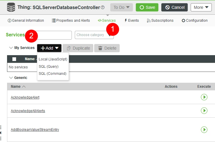

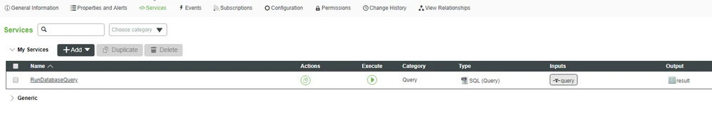

  1. In the DatabaseController entity, go to the Services tab.
  2. Create a new service of type SQL (Query) called RunDatabaseQuery.
      3. Set the Output as InfoTable, but do not set the DataShape for the InfoTable.
      4. Add the following parameter:
NameBase TypeRequired
queryStringTrue

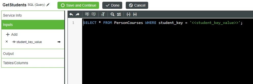

5. Add the following code to the new service:
<<query>>
6. Click Save and Continue. Your service signature should look like the below example.
You now have a service that can run queries to the database. This is also a simple method to test/troubleshoot the database connection or a quick query.

Now, let's utilize the second method to create a query directly to the database. You can use open and close brackets to create parameters for your query. You can also use <> as a method to mark a value that will need to be replaced. As you build your query, use [[Parameter Name]] for parameters/variables substitution and <> for string substitution.
  1. In the Services tab of the DatabaseController entity, create a new service of type JavaScript.
  2. Name the service SQLQuery_GetPersonByEmail.
  3. Ensure the Output is InfoTable.
  4. Add the following code to your new service:
SELECT * FROM Persons WHERE person_email = [[email]];
