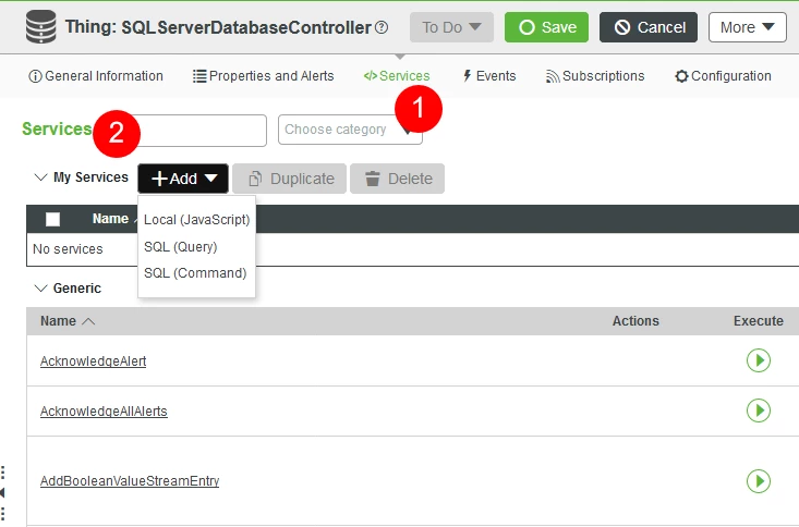

In the DatabaseController entity, go to the Services tab.
2. Create a new service of type SQL (Command) called RunDatabaseCommand.

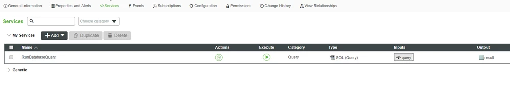

6. Click Save and Continue. Your service signature should look like the below example.
You now have a service that can run commands to the database. Run your service with a simple insert.

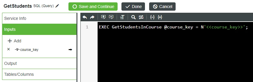

  1. In the DatabaseController entity, go to the Services tab.
  2. Create a new service of type SQL (Query) called GetStudentCoursesStoredProcedure.
  3. Set the Output as InfoTable, but do not set the DataShape for the InfoTable.
  4. Add the following parameter:
NameBase TypeRequired
course_keyStringTrue
      5. Add the following code to your new service:
EXEC GetStudentsInCourse @course_key = N'<<course_key>>'
