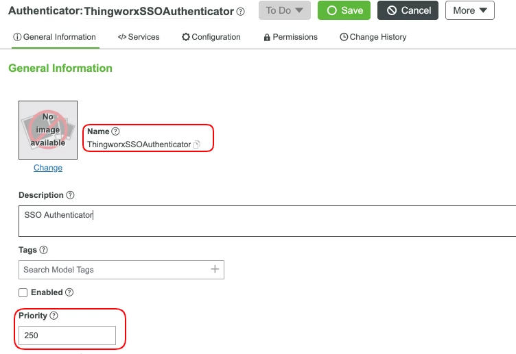

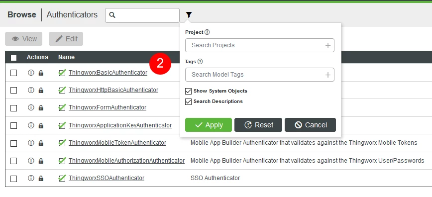

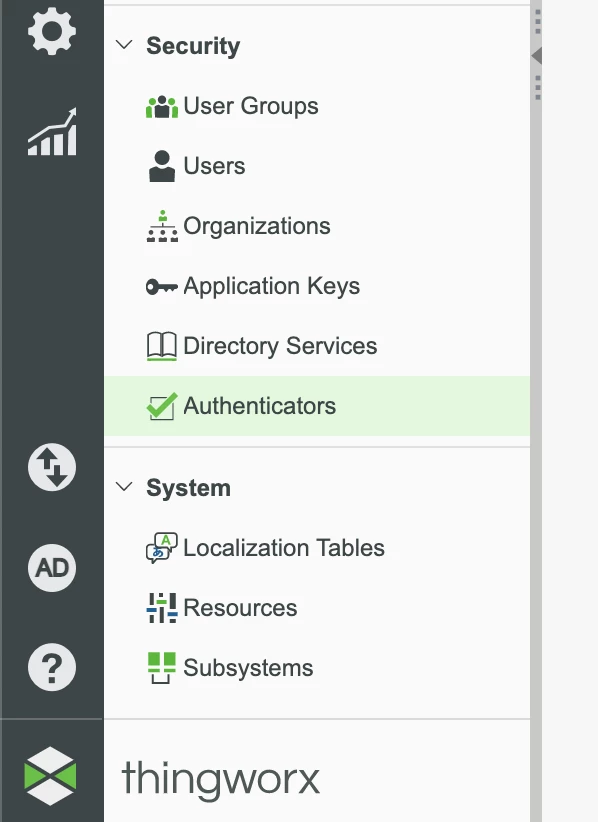

For setting the priority follow the instructions below:
  1. Navigate to and select Security > Authenticators.
  2. Select the Authenticator you would like to edit (ie, ThingworxSSOAuthenticator). If you do not see a specific Authenticator you would like to VIEW ONLY, check the Show System Objects checkbox in your search filter.
  3. Update the Priority field with a new value.
  4. Click Save.
