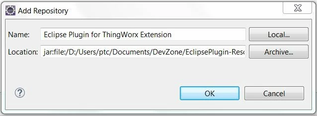

  3. After the Install window opens, click Add to add the Eclipse Plugin repository.
  4. Click Archive… and browse to the directory where the Eclipse Plugin zip file is stored and click Open.
    NOTE: Do not extract this zip file.
  5. Enter a name (for example, Eclipse Plugin).
  6. Click OK.

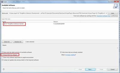

  7. Ensure that the Group items by category checkbox is not selected.
  8. Select ThingWorx Extension Builder in the items list of the Install window.
  9. Click Next and the items to be installed are listed.
  10. Click Next and review the license agreement.
  11. Accept the license agreement and click Finish to complete the installation process. If a warning for unsigned content is displayed, click OK to complete the installation process.

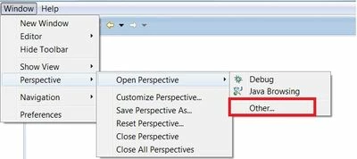

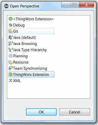

  13. When Eclipse starts again, ensure that you are in the ThingWorx Extension perspective. If not, select Window->Perspective->Open Perspective->Other->ThingWorx Extension, then click OK.
NOTE: Opening any item from File->New->Other…->ThingWorx will also change the perspective to ThingWorx Extension.

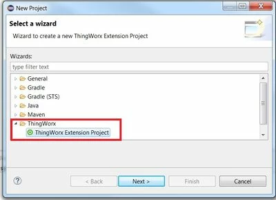

  1. While in the ThingWorx Extension Perspective, go to File->New->Project.
  2. Click ThingWorx->ThingWorx Extension Project.
  3. Click Next.

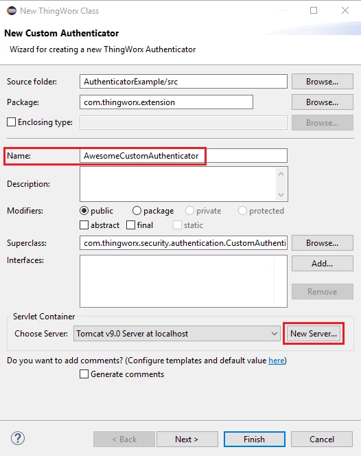

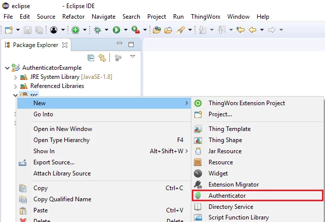

Create New Authenticator
  1. Select your project and click New -> Authenticator to create a new Authenticator.
  2. In the new window, enter AwesomeCustomAuthenticator for the Name.
  3. If no Server is available, create a Server using any available option. You will not need that for this guide. This Server option might be utilized based on your later needs.
  4. Enter a description to your Authenticator, such as Sample Authenticator that validates against the Thingworx User.
  5. Select Finish.
You will be able to check these settings within the metadata.xml file inside of the configfiles  directory.

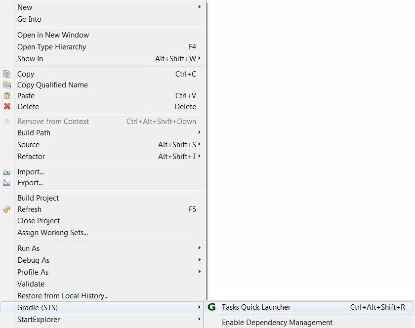

Build Extension with Gradle
  1. Right click on your project ->Gradle (STS)->Tasks Quick Launcher.
  2. Set Project from the drop-down menu to your project name and type Tasks as build.

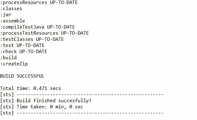

  3. Press Enter. This will build the project and any error will be indicated in the console window.
  4. Your console window will display BUILD SUCCESSFUL. This means that your extension is created and stored as a zip file in your_project->build->distributions folder.

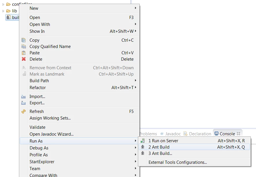

Build Extension with Ant
  1. Go to the Package explorer -> your_project->.
  2. Right click on build-extension.xml->Run As->Ant Build.
  3. Your console output will indicate BUILD SUCCESSFUL similar to the below text:
build:
 [echo] Building AuthenticatorExample extension package...
BUILD SUCCESSFUL
Total time: 770 milliseconds
NOTE: This will build your project and create the extension zip in the AuthenticatorExample->build->distributions folder of your project.
