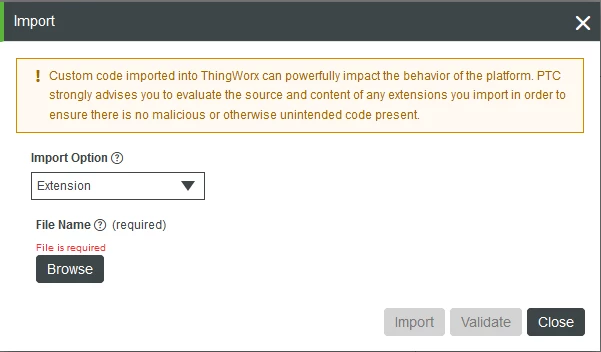

  1. In the ThingWorx Composer. in the bottom left, click Import/Export, then select Import.
NOTE: The build produces a zip file in AuthenticatorExample->build->distributions folder. This zip file will be required for importing the extension.
       2. For the Import Option field, select Extension.
       3. Click Browse and choose the zip file in the distributions folder (located in the Eclipse Project's build directory).
      4. Click Import to finalize the import.

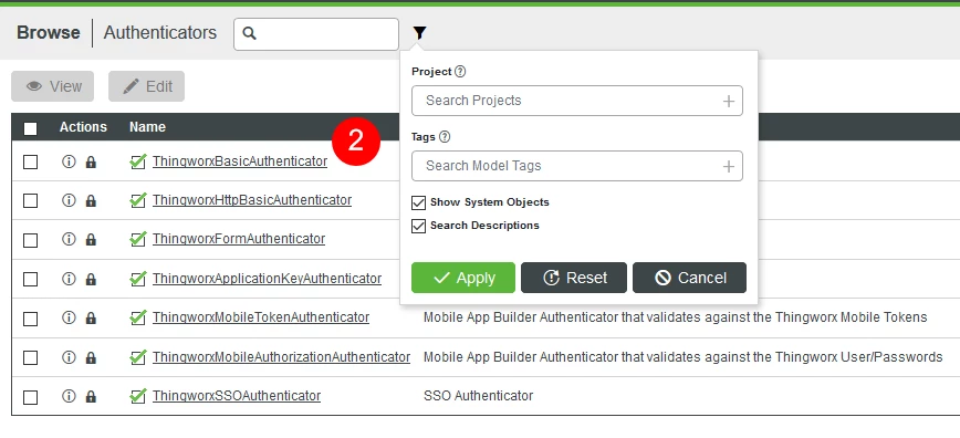

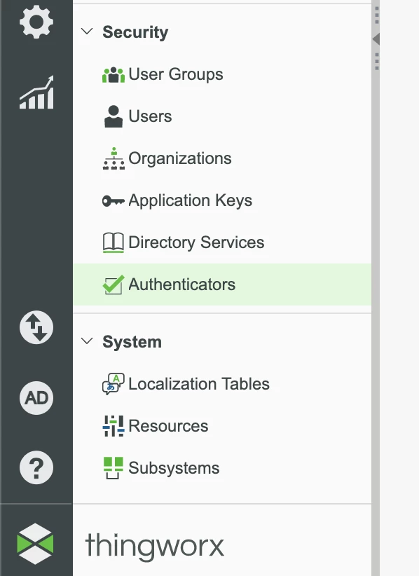

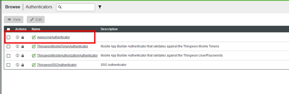

Navigate to New Authenticator
  1. Navigate to and select Security > Authenticators.
      2. You will now see your CustomizedAuthenticator Authenticator as a option to view/edit.
       3. Click Edit or View to see this new Authenticator. You wil notice the priority is 1.

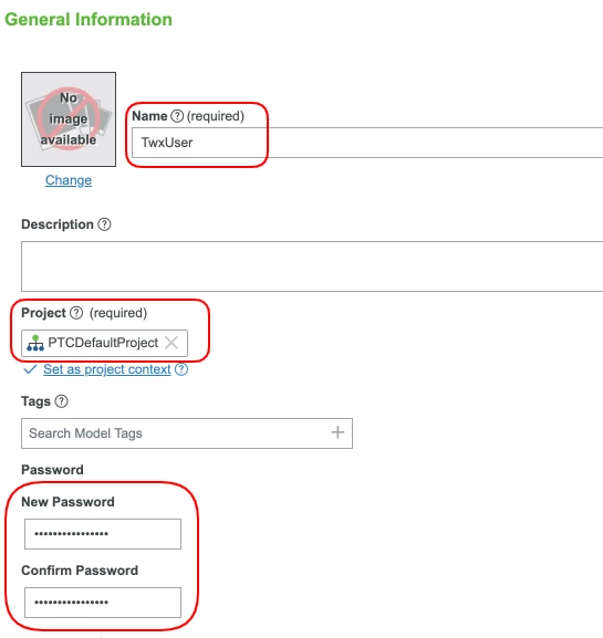

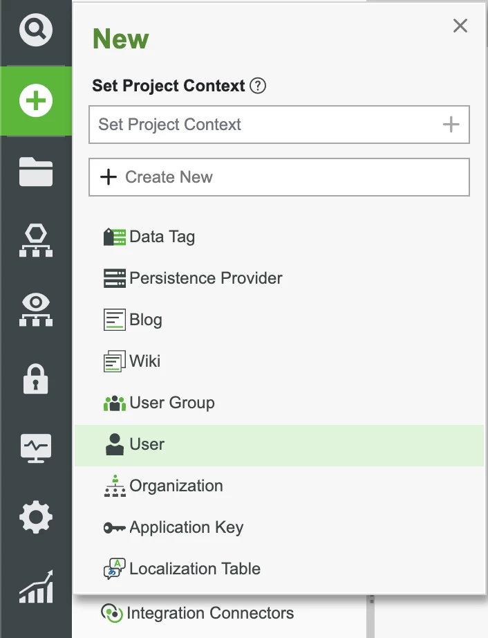

Create ThingWorx User
Let's create the User that we will be processing login attempts.

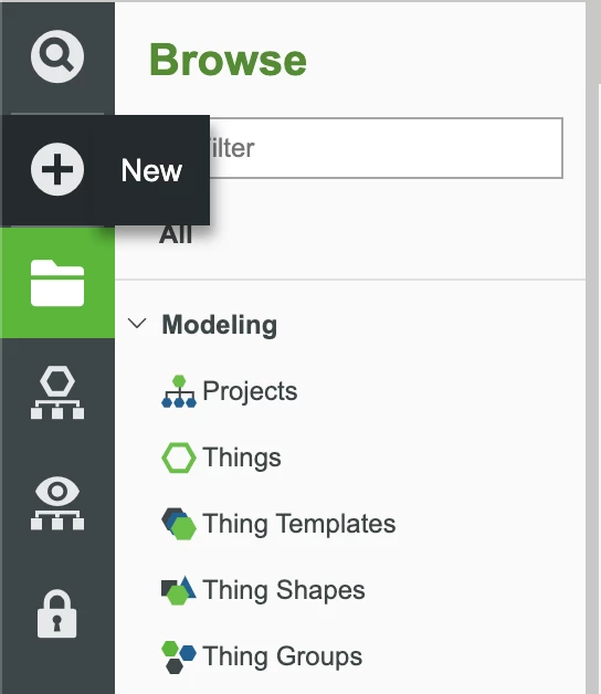

  1. In the ThingWorx Composer, click the + at the top left of the screen.
  2. Select User in the dropdown.
  3. Set the Project (ie, PTCDefaultProject) and enter the Name for this new user as TwxUser.
  4. Enter the Password for the new user to something easy to remember (ie, 2020Password2021).
  5. Click Save.

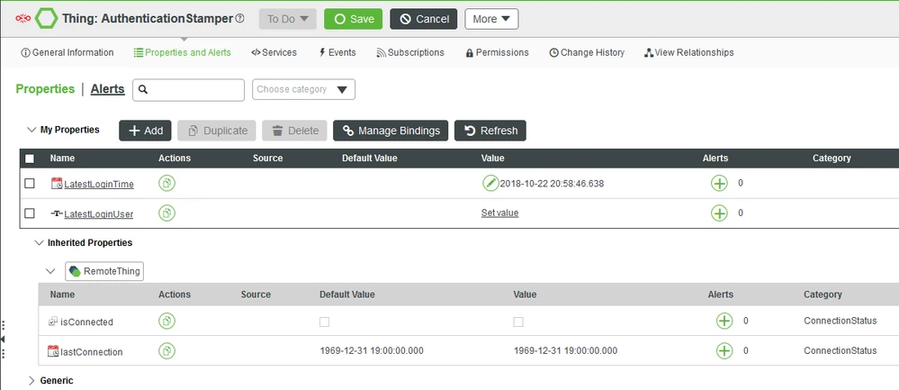

  1. Create a Thing named AuthenticationStamper to go with the LoginHelper variable in the earlier Java source code. Ensure this new Thing inherits from the RemoteThing
  2. Match the properties for the AuthenticationStamper with the two properties in the below image.
  3. Save the changes.

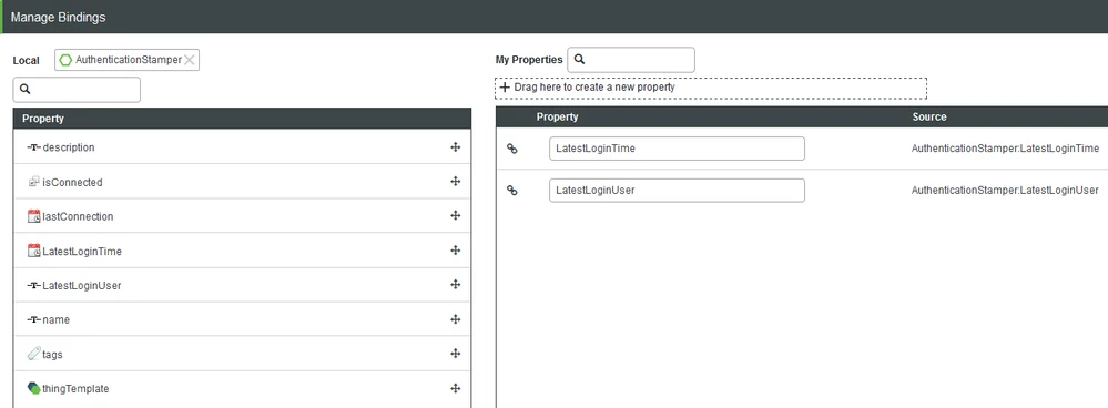

Create Login Helper
Create a stream for authentication attempts for helpful tracking.
  1. Create a ValueStream named AuthenticationStream and Save the Entity.
  2. In the Properties and Alerts section of the ValueStream, click Manage Bindings.
  3. Setup the binding to match the below configurations. Bind the properties to the AuthenticationStamper Thing.
  4. Save the changes made to the ValueStream.

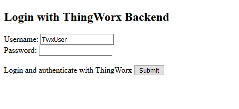

Demo Page Login
With a browser, open the TestSite.html web page found in the Demo directory of the download. You should see a login page similar to that as the below image.
  1. Enter the name of the user we created, TwxUser.
  2. Enter the password for the user. We suggested setting this to Password2019.
  3. Click Submit. You will now be authenticated and logged in.
