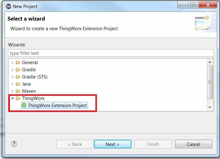

  1. Go to File->New->Project.
  2. Click ThingWorx->ThingWorx Extension Project.
  3.  Click Next.

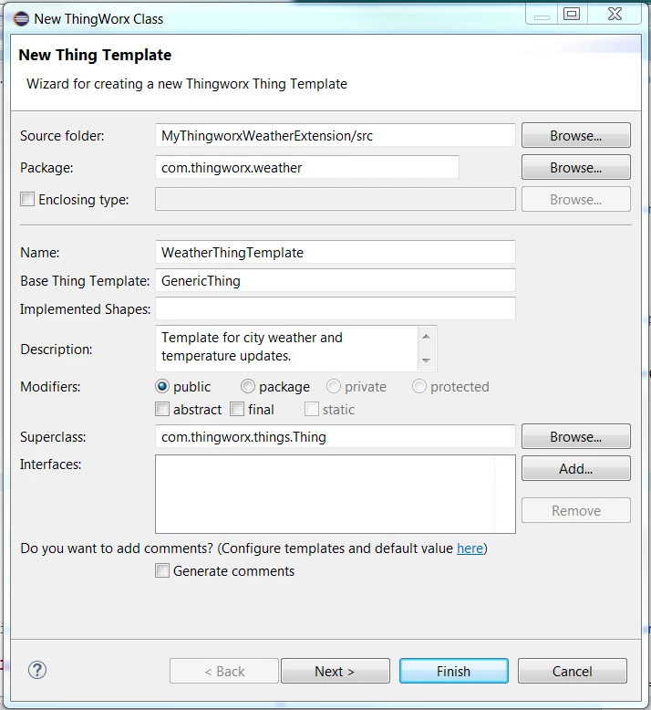

  3. In the pop-up window, browse to add the source folder of your project in Source Folder.
    NOTE: It should default to the src directory of your project. In our case it will be MyThingworxWeatherExtension/src.
  4. Browse to add the package where you want to create this new class, or simply give it a name (such as com.thingworx.weather).
  5. Enter a name and description to your Thing Template (WeatherThingTemplate).
     NOTE: By default, the Base Thing Template is set to GenericThing.
  6. Select Next.
    NOTE: If you want to give other users of this entity permission to edit it in ThingWorx Composer, select the entity as an editable entity. Only non-editable entities can be upgraded in place; editable entities must be deleted and recreated when your extension is updated. If you need to make it possible to customize the extension, consider using a configuration table to save user customizations.
  7. Select Finish.
  8. Verify that you have a WeatherThingTemplate class created that extends the Thing class.

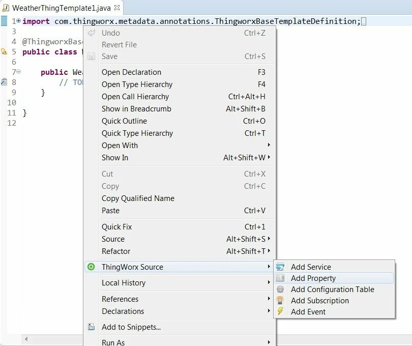

  1. Right click inside the WeatherThingTemplate class or right click on the WeatherThingTemplate class from the Package Explorer.
  2. Select ThingWorx Source-> Add Property.

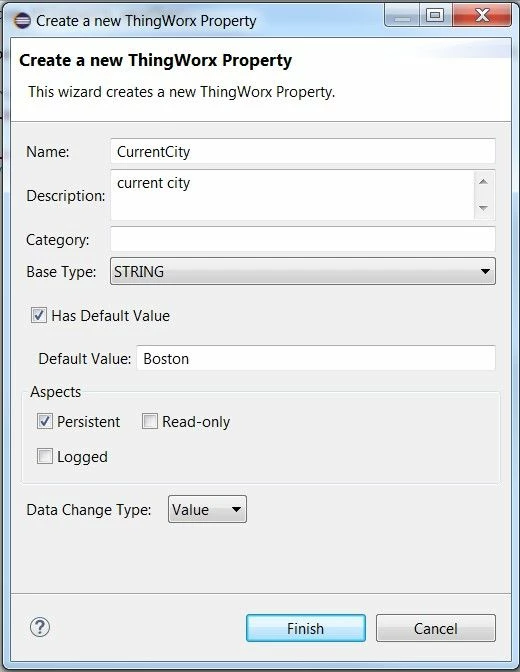

  3. In the popup window, create a property to store the city name.
    • Name = CurrentCity, Base Type = STRING, Description = ‘’
    • Select the Has Default Value checkbox and enter a city name (eg. Boston). This will be the default value unless a specific value is passed.
    • Select the “Persistent” checkbox. This will maintain the property value if a system restart occurs. NOTE: If you select the Logged checkbox, the property value is logged to a data store. If you select the Read Only checkbox, the data will be static.
    • Select VALUE from the Data Change Type drop down menu
          NOTE: This allows any Thing in the system to subscribe to a data change event for this property.
  4. Choose to use one of the following Data Change Types:
    Data ChangeType Description
    AlwaysFires the event to subscribers for any property value change
    NeverDoes not fire a change event
    OnFor most values, any change will trigger this.
    OffFires the event if the new value is false
    ValueFor numbers, if the new value has changed by more than the threshold value, fire the change event. For non-numbers, this setting behaves the same as Always.
  5. Select Finish.

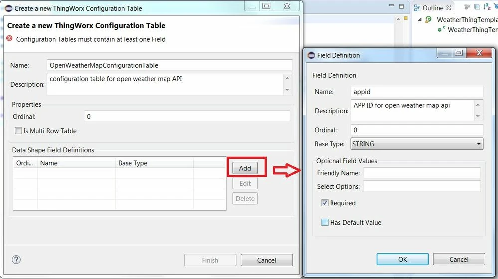

  1. Right-click inside the WeatherThingTemplate class and select ThingWorx Source->Add Configuration Table.
  2. Create a new configuration table with name OpenWeatherMapConfigurationTable.
  3. Click Add in the Data Shape Field Definitions frame.
    NOTE: Configuration tables require fields (columns) with a defined table structure (DataShape).
  4. Enter appid as the name with a base type STRING.
  5. Select the Required checkbox.
  6. Click OK, then Finish to add the Configuration Table
