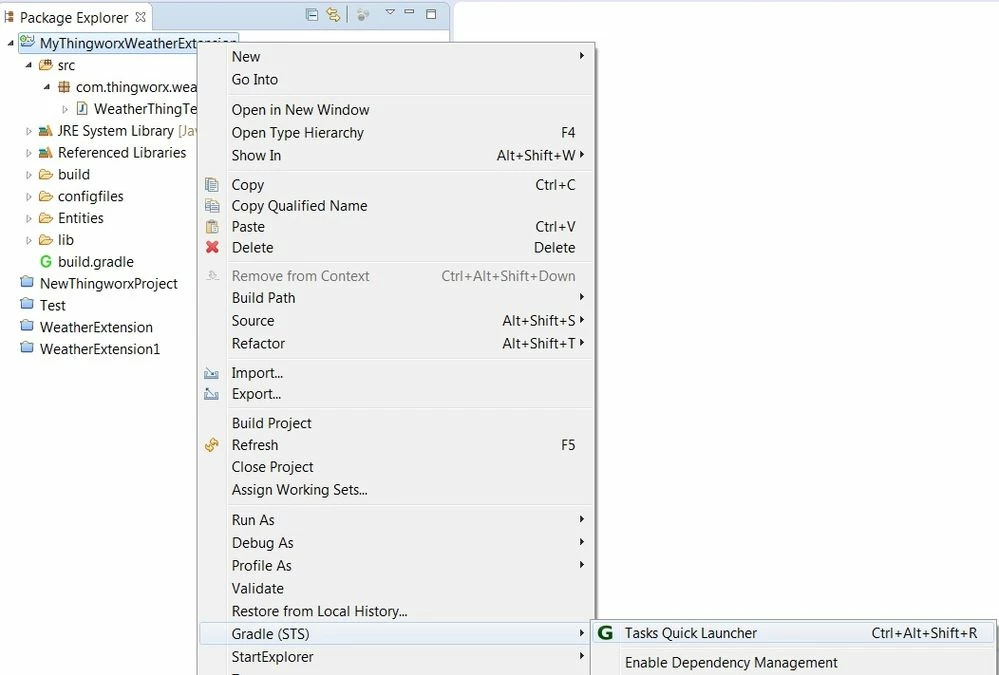

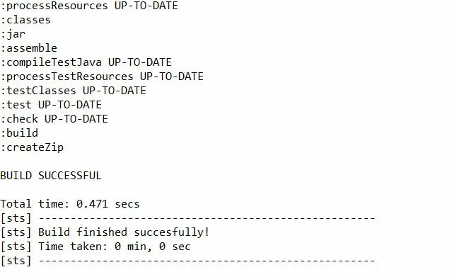

Build Extension with Gradle
  1. Right click on your project ->Gradle (STS)->Tasks Quick Launcher.
    NOTE: This opens up a new window.
  2. Set Project from the drop-down menu to your project name and type Tasks as build.
  3. Press Enter
    NOTE: This will build the project and any error will be indicated in the console window.
  4. Your console window will display BUILD SUCCESSFUL. This means that your extension is created and stored as a zip file in your_project->build->distributions folder.

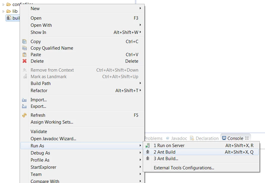

Build Extension with Ant
  1. Go to the Package explorer -> your_project->.
  2. Right click on build-extension.xml->Run As->Ant Build
  3. Your console output will indicate BUILD SUCCESSFUL.
    NOTE: This will build your project and create the extension zip in the your_project->build->distributions folder of your project.

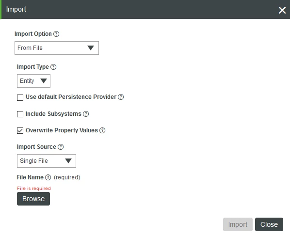

Import Extension
  1. In the lower left corner, click Import/Export, then select Import.
    NOTE: The build produces a zip file in ProjectName->build->distributions folder. This zip file will be required for importing the extension.
  2. For the Import Option option, select Extension.
  3. Click Browse and choose the zip file in the distributions folder (located in the Exclipse Project's build directory). Click Import.

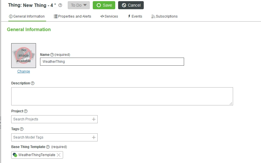

Create a Thing

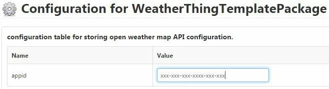

  1. Create a Thing using the ThingWorx Composer with the Thing Template set to the WeatherThingTemplate.
  2. Open the ConfigurationTable tab and add the appid from the OpenWeatherMap.org site.

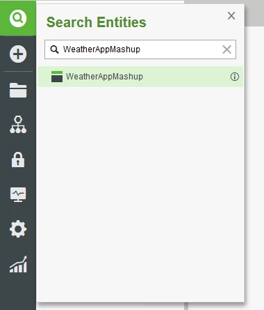

  3. Open the WeatherAppMashup Mashup by searching for WeatherAppMashup in the Search bar.
  4. Click View Mashup in the WeatherAppMashup Mashup window.

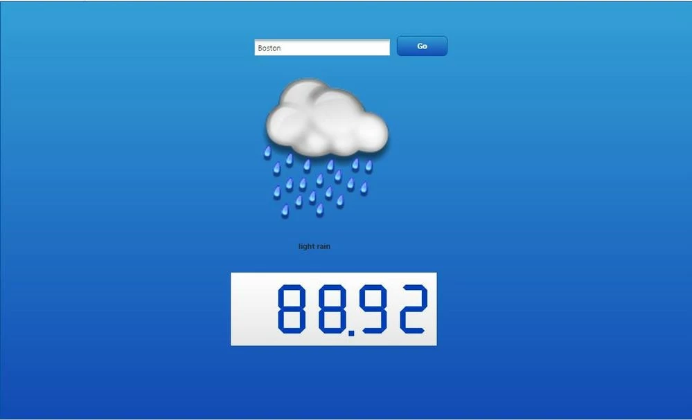

  5. Type the name of a city (eg. Boston) and click go.
    NOTE: You can now see the current temperature reading and weather description of your city in the Mashup.

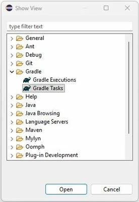

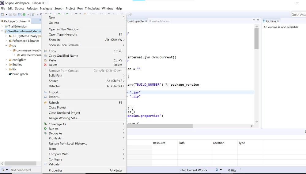

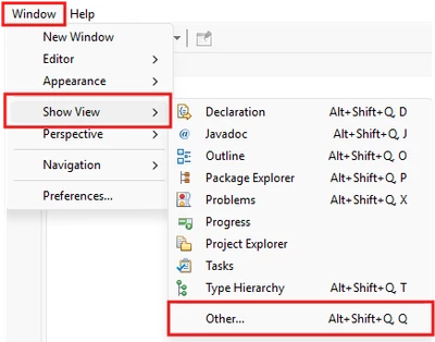

I am not able to build this project at the build step of this tutorial.
Im having gradle installed on system and also installed gradle buildship in my eclipse but still not getting option to build with gradle as shown in above images for this tutorial.
I need help on this issue to finish and conclude this tutorial.
2-Explorer
Replying to MB_10808246
If you don't have the Gradle (STS) when you right click on the project, you can go to "Window->Show View->Other..."
Then on the popup you go on "Gradle-> Gradle Tasks" and click open.
On the bottom panel there should be a "Gradle Tasks" menu that pops up.
On this menu you go to "MyThingworxWeatherExtension->Build->Run Gradle Tasks" and it should be good.
