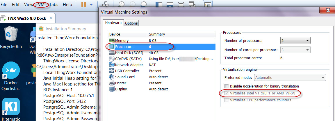

  • At some point during or after the installation, it will prompt you to enable Hyper-V
    • If this is a physical server, these settings will be in your Bios

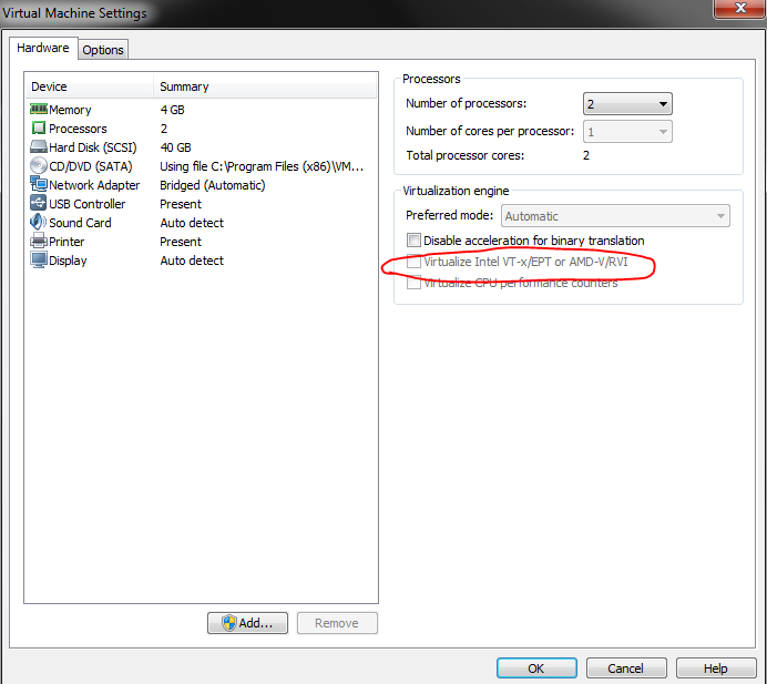

    • For VMWare, while the VM is powered down, go to VM-> Virtual Machine Properties -> Hardware -> Processors -> Enable 'Virtualize Intel VT-x/EPT or AMD-V/RVI'
  • Restart, and make sure Docker is running (whale icon in your system tray for the Windows Server 2016 edge version)

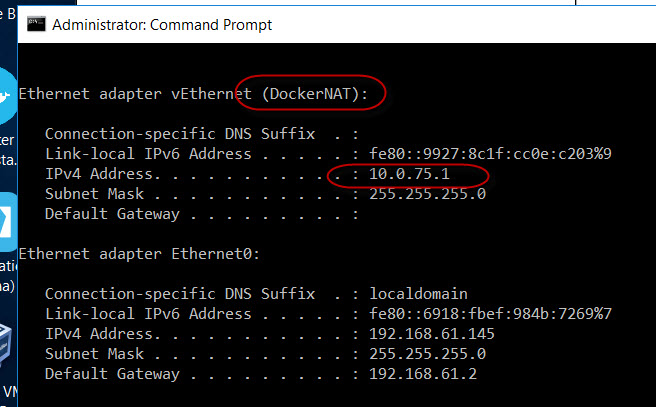

  • With Docker running, open a command prompt and look at your IP settings
    • For windows Server 2016, right click the start menu -> Command Prompt (admin) and run IPCONFIG
  • Write down the IP assigned to DockerNAT, as this is will be your Postgres HOST later

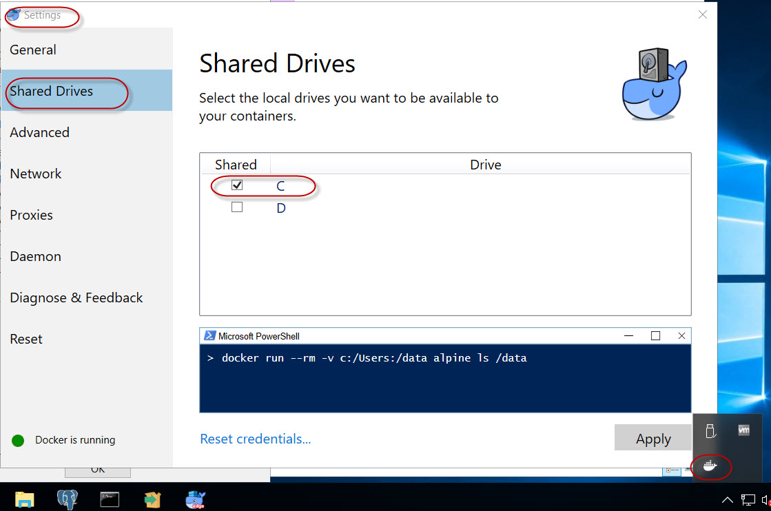

  • Share your main drive with Docker
    • In Windows Server 2016, right click the docker icon in the system tray -> Settings -> Shared Drives -> C:

  • Below is a capture of the settings used in the above screenshots.  Anything not listed (like specifying the container name, which is twxfoundation by default) was left as the default values:
      Installation Directory: C:\Program Files (x86)\twxEnterpriseFoundationPostgresDocker
      ThingWorx License Directory: C:\Users\Administrator\Desktop\license.bin
      Local ThingWorx Foundation Port: 8080
      Java Initial Heap setting for TWX Foundation: 1024
      Java Max Heap setting for TWX Foundation: 2048
      RDS Instance: 1
    PostgreSQL Host: 10.0.75.1
      PostgreSQL Port: 5432
      PostgreSQL Admin Schema: postgres
      PostgreSQL Admin Username: postgres
      PostgreSQL Admin Password: <see note>
      PostgreSQL ThingWorx Foundation Schema: thingworx
      PostgreSQL ThingWorx Foundation Username: thingworx
      PostgreSQL ThingWorx Foundation Password: <see note>
      PostgreSQL ThingWorx Tablespace Location: /

Hi Tony,
I installed Thingworx on centos 7 with Docker installation package in a vm.
My issue is that I could not setup the bridge connection with docker.
When I followed your instruction,
https://community.thingworx.com/servlet/JiveServlet/showImage/38-1476-6261/HyperV.jpg
You have this option, but it's gray and could not be clicked in my virtual machine.
Could you give some suggestions?
Br,
Anna
tschmitz14-AlexandriteAuthor
July 14, 2017
Hi Anna An​,
Make sure the VM is powered down, and that should allow you to make the changes.
Tony
July 24, 2017
Hi Tony,
Yes it worked after powering off the VM:)
