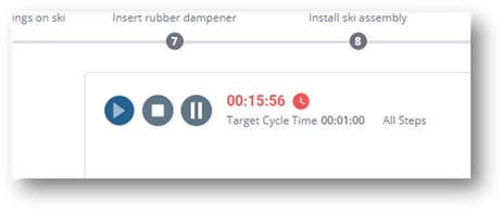

As a human reaction, the tracked time displayed may be misperceived by the Operator. It can lead to a reject of the solution. CWC doesn’t have (yet?) the capability to configure the visibility to hide the timer. The purpose of this tutorial is to create a quick and straight to the point customization to hide the timer in the execution screen. All other features, services and interfaces are left untouched.

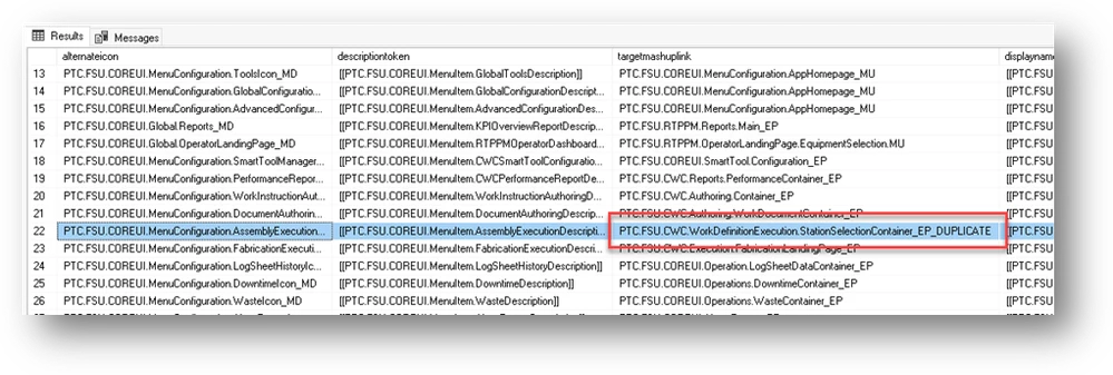

Now, let’s change the database value. In MSSQL, navigate to the thingworxapps database, and edit the dbo.menu table. Look the line for AssemblyExecution (by default line 22) and look the value in column targetmashuplink. Switch the original value PTC.FSU.CWC.WorkDefinitionExecution.StationSelectionContainer_EP to the name of the duplication of this mashup.

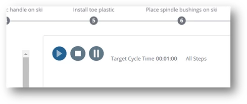

Result
After this modification, you can start and check an operation. You should see the following result:
