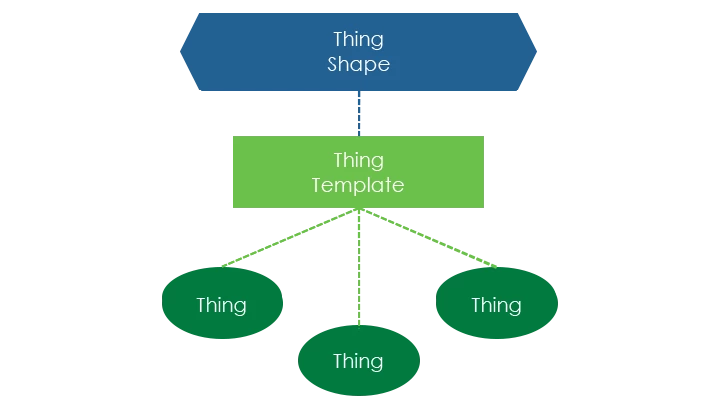

Defining Things, Thing Templates, and Thing Shapes in your Data Model allows your application to handle both simple and complex scenarios.
Entity | Function |
Thing Shapes | Assemble individual components. |
Thing Templates | Combine those components into fully functional objects. |
Thing | Unique representation of a set of identical components defined by the Thing Template. |

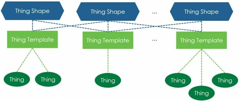

In this example, there is a Parent/Child model between two related Thing Templates.
NOTE: Things and Thing Templates may only inherit ONE Thing Template. Both Things and Thing Templates may inherit any number of Thing Shapes.
Thing Templates employ a linear-relationship, while Thing Shapes employ a modular-relationship. Any Thing or Thing Template may have any number of sub-components (i.e. Thing Shapes), but each Thing or Thing Template is just one description of one object as a whole.
How you decide to compartmentalize your Data Model into Thing Shapes and Thing Templates to create the actual Things that you’ll be using is a custom design that will be specific to each implementation.

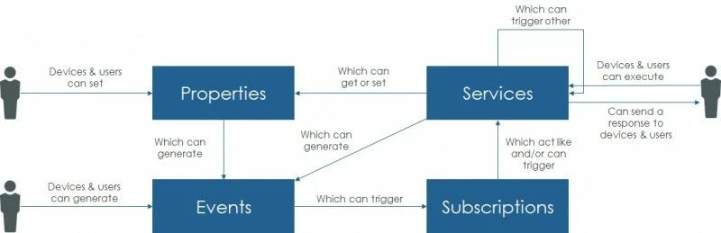

The ThingWorx Data Model provides a way for you to describe your connected devices and match the complexity of a real-world scenario. Things, Thing Templates, and Thing Shapes are building blocks that define your data model.
You can define the components of Things, Thing Templates, and Thing Shapes, including Properties, Services, Events, and Subscriptions.
Component | Definition |
Properties | Each Property has a name, description, and a data type (Base Type). Depending on the base type, additional fields may be enabled. A simple scalar type, like a number or string, adds basic fields like default value. More complex base types have more options. Properties can be static (i.e. Model Number) or dynamic (i.e. Temperature). |
Services | A Service is a method/function defined by a block of code that performs logic specifying actions a Thing can take. There are several implementation methods, or handlers (for example: Script, SQLQuery, and SQL command), for services depending on the template you use. The specific implementation of a user-defined Service is done via a server-side script. The Service can then be invoked through a URL, a REST client capable application, or by another Service in ThingWorx. When you create a new service, you can define input properties and an output. You can define individual runtime permissions for each Service. |
Events | Events are triggers that define changes of state (example: device is on, temperature is above/below threshold) of an asset or system and often require an action to correct or respond to a change. Business logic and actions in a ThingWorx application are driven by Events. |
Subscriptions | Action associated with an Event, primary method to set up intelligence in ThingWorx model which enable you to optimize/automate. Subscriptions use Javascript code to define what you want your application to do when the Event occurs. |

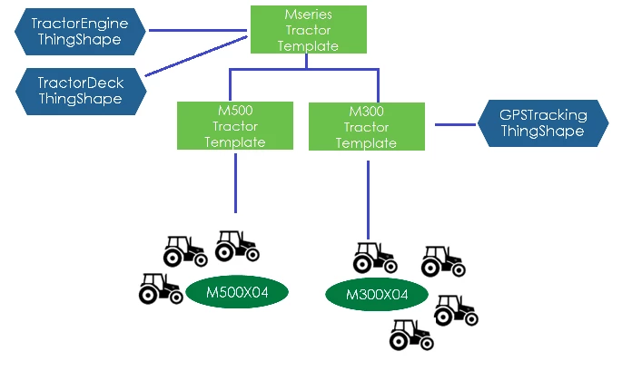

This diagram shows what a specific Inheritance Model might look like for a connected Tractor.
There is one master Template at the top. In this case, it’s a collection of similar types of tractors.
The parent Template inherits a few Shapes - an Engine and a Deck that have been used in previous designs. Importing them as Shapes allows us to reuse previous design work and expedite the development process. One of the child Templates incorporates another Shape, this time in the form of a GPS tracking device. Then, at the bottom, there are the specific tractors with individual serial numbers that will report their connected data back to an IoT Application.
