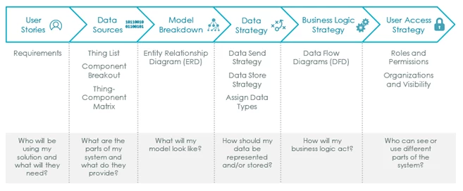

Step 1: Data Model Methodology
We will start by outlining the overall process for the proposed Data Model Methodology.
| Step | Description |
1 | User Stories | Identify who will use the application and what information they need. By approaching the design from a User perspective, you should be able to identify what elements are necessary for your system. |
2 | Data Sources | Identify the real-world objects or systems which you are trying to model. To create a solid design, you need to identify what the “things” are in your system and what data or functionality they expose. |
3 | Model Breakdown | Compose a representative model of modular components to enable uniformity and reuse of functionality wherever possible. Break down user requirements and data, identifying how the system will be modeled in Foundation. |
4 | Data Strategy | Identify the sources of data, then evaluate how many different types of data you will have, what they are, and how your data should be stored. From that, you may determine the data types and data storage requirements. |
5 | Business Logic Strategy | Examine the functional needs, and map them to your design for proper business logic implementation. Determine the business logic as a strategic flow of data, and make sure everything in your design fits together in logical chunks. |
6 | User Access Strategy | Identify each user's access and permission levels for your application. Before you start building anything, it is important to understand the strategy behind user access. Who can see or do what? And why? |
NOTE: Due to the length of this subject, the ThingWorx Data Model Methodology has been divided into multiple parts. This guide focuses on the first three steps = User Stories, Data Sources, and Model Breakdown. Guides covering the last three steps are linked in the final Next Steps page.

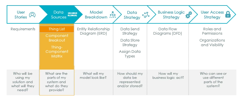

Step 3: Data Sources – Thing List
Thing List
Once you have identified the users' requirements, you'll need to determine what parts of your system must be connected. These will be the Things in your solution. Keep in mind that a Thing can represent many different types of connected endpoints.
Here are some examples of possible Things in your system:
- Devices deployed in the field with direct connectivity or gateway-connectivity to Foundation
- Devices deployed in the field through third-party device clouds
- Remote databases
- Connections to external business systems (e.g., Salesforce.com, Weather.com, etc.)
Factory Example
In our Smart Factory example, we have already identified the users of the system and listed requirements for each of those users. The next step is to identify the Things in our solution.
In our example, we are running a factory floor with multiple identical production lines. Each of these lines has multiple different devices associated with it.
Let’s consider each of those items to be a connected Thing.
Things in each line:
- Conveyor belt x 2
- Pneumatic gate
- Robotic Arm
- Quality Check Camera
Let's also assume we already have both a Maintenance Request System and a Production Order System that are in use today.
To add this to our solution, we want to build a connector between Foundation and the existing system. These connectors will be Things as well.
- Internal system connection Thing for Production Order System
- Internal system connection Thing for Maintenance Request System
NOTE: It is entirely possible to have scenarios in which you want to examine more granular-level details of your assets. For example, the arm and the hand of the assembly robot could be represented separately. There are endless possibilities, but for simplicity's sake, we will keep the list shorter and more high-level. Keep in mind that you can be as detailed as needed for this and future iterations of your solution. However, being too granular could potentially create unnecessary complexity and data overload.
