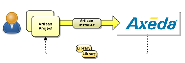

The Artisan framework is comprised of several components:
The Axeda Platform
Each instance of the Axeda Platform contains libraries and sample Artisan Projects (archetypes) that are downloaded by developers to author and deploy their own Artisan Projects.
The Artisan Project
An Artisan Project is a collection of content and configuration files that are used to define a set of objects that will be installed on the Axeda Platform.
The Artisan Installer
The Artisan Installer is a flexible, configurable application that uses the Apache Maven build life-cycle to upload the contents of an Artisan Project to the Axeda Platform.
Axeda Platform APIs
The Artisan Installer interacts with the Axeda Platform and uses Axeda APIs to install, upgrade, or uninstall ArtisanProjects.
