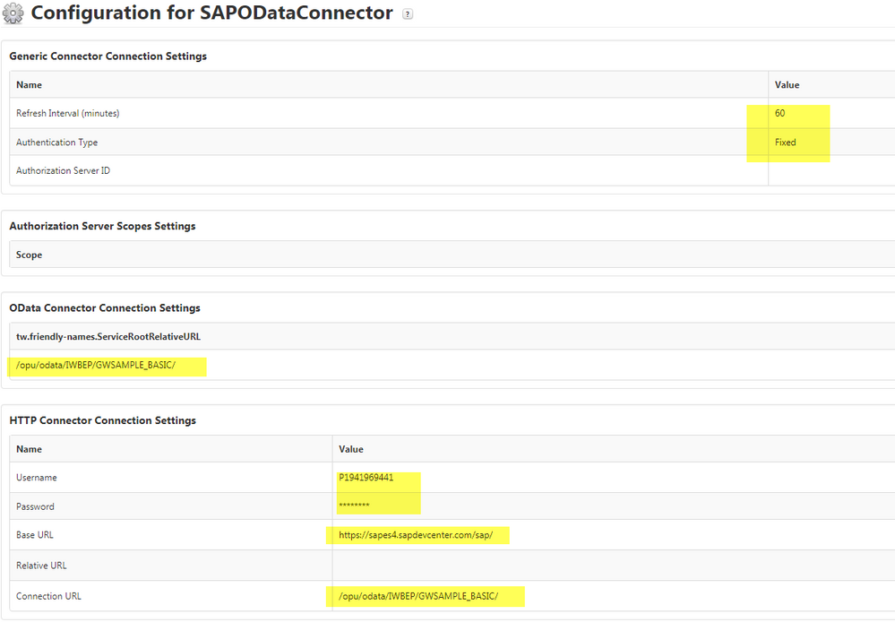

1. OpenSAPODataConnector and configure connection settings:

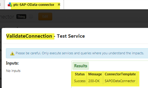

image2. Save the connector and go to services and execute service ValidateConnection to validate that 200 OK status is returned:

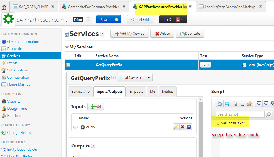

3. Open SAPPArtResourceProvider Thing and then Services and Edit the Service and in the script Enter the
var results=””
Note: This is the Prefix used to get data from SAP which is added before the Part Number

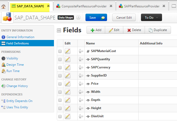

4. Open the Data shape SAP_DATA_SHAPE and create the three Data Fields as below and save the Data Shape
SAPMaterialCost => Type => Number
SAPQuantity => Type => String
SAPCurrency => Type => String
SupplierID => Type => String
Price => Type => String
With => Type => String
Depth => Type => String
Height => Type => String
DimUnit=> Type => String

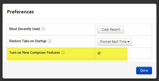

5. Open the New Composer by setting the below preference from Administrator:

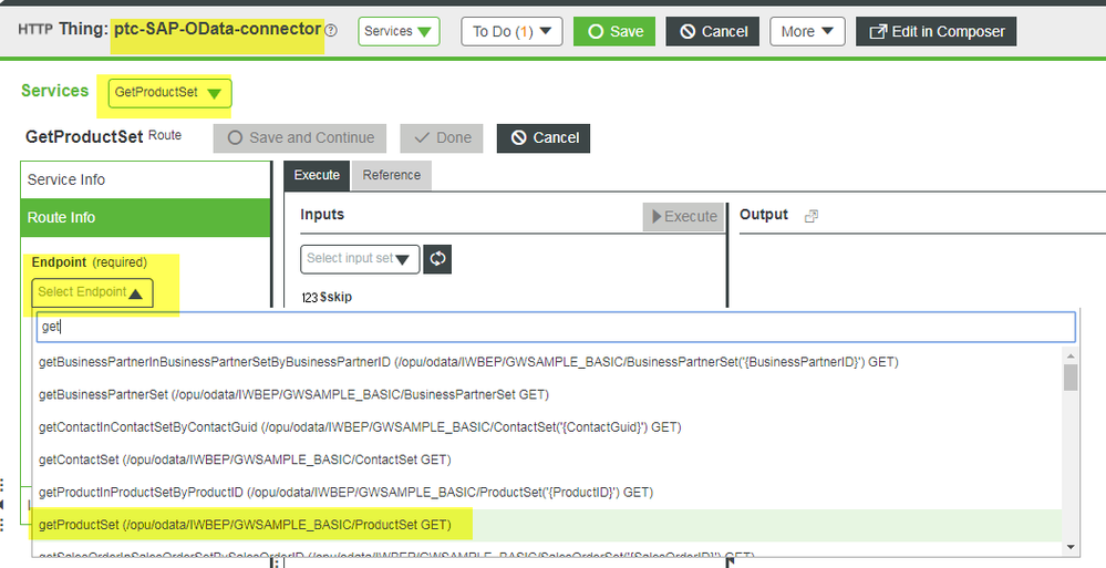

6. In New Composer open Thing ptc-SAP-OData-Connector, Services and edit the service GetProductSet in the Route info Select the End Point getProductSet. Click Done and save the Service:
imageExecute the service GetProductSet and check that data is fetched from SAP.

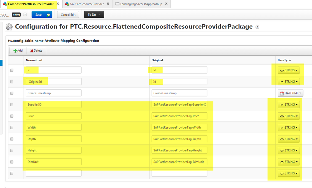

8. Open CompositePartResourceProvider and edit Attribute Mapping Configuration and ass attributes defined earlier on SAP_DATA_SHAPE:

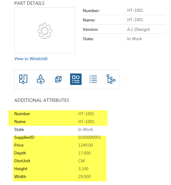

10. Search for some Part and open information page and check that SAP attributes are populated:
